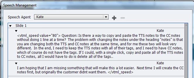

I have the opening tag, <vtml_speed value="80"> at the front of each line, and the closing tag, </vtml_speed>, at the end of each line.
I tried using a single opening tag at the start of the first line in the slide, and the closing tag at the end of the last line in the slide, and it didn't work...
March 26, 2014
Hi
Here is the difference.
1.  This doesn't work.

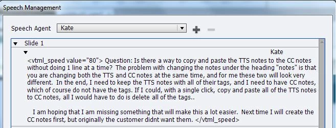

2.  This works.
Sreekanth
