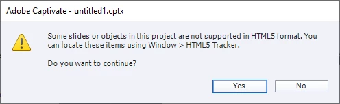

    We don't want to use Rollover image for the below reason(attached image below).
    So, as an alternative im using a button/shape and using its rollover state for the same functionality. But, Why am i getting the issue - when clicked on the button, the image flickers (The rollover image either goes off or on when clicked on the button).

    RodWard
    Aug 27, 2020 12:07 AM UTC
    That warning message will always appear when using rollover objects now because it is just warning you about the fact that touch screen mobile device users will not be navigating with a mouse so the rollovers won't be useful.  You can ignore this message if your users will primarily be desktop computer users.
