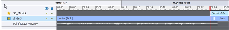

    You have a double issue, because neither audio clip can be controlled. The Submit button cannot be timed, it is also an embedded object. Otherwise it would be possible to have the Submit button appear only after the end of the audio clip. I have a 'cheating' work flow however:
    1. Create a shape that looks identical to the present Submit button but do not indicate it as a button: use Fill, Stroke and type the text Submit in it
    2. Delete the label of the Submit button, change its Fill to 0% Alpha and stroke width to 0pt, so that it becomes invisible to the user
    3. Move the pausing point of the Quiz slide timeline till after the audio clip
    4. Move the playhead in the Timeline panel to a little bit before the pausing point
    5. Move the shape that you created to that point on the timeline (CTRL-L) and have it in exact the same location as the real Submit button
    Try it out. I checked both in Browser and HTML in browser

    I tested it out!
