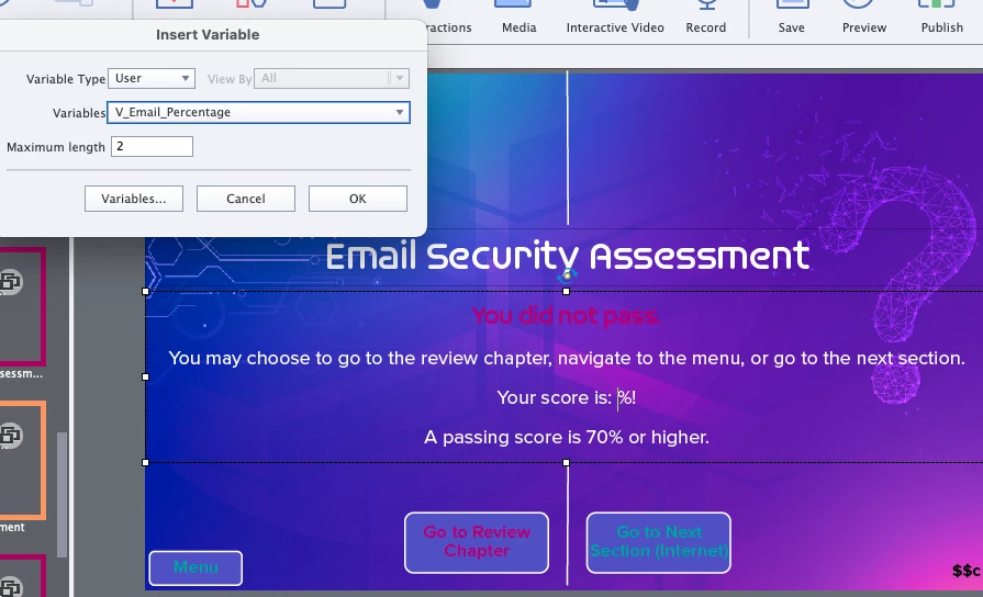

Issues with rounding variables

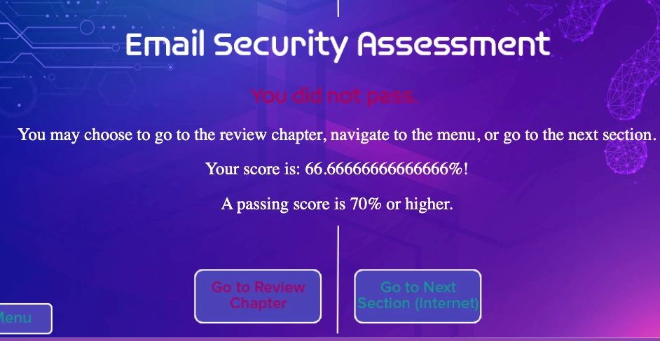

I setup a variable for interim quiz scoring slides and when it displays it does so with many decimal places. When I insert the variable I limited the length to 2. Any ideas of other ways to do this? The advanced action for scoring is on the Captivate blog link above.

You are using one of my blog post workflows. Editing the length of the inserted variable will not help for HTML output, nor will restricting the size of the text container. You need to use JavaScript to format the variable. You can find a script for that in this blog post:
https://blog.lilybiri.com/percentage-progress-indicator-non-linear-course-solution-2
It is at the end.
