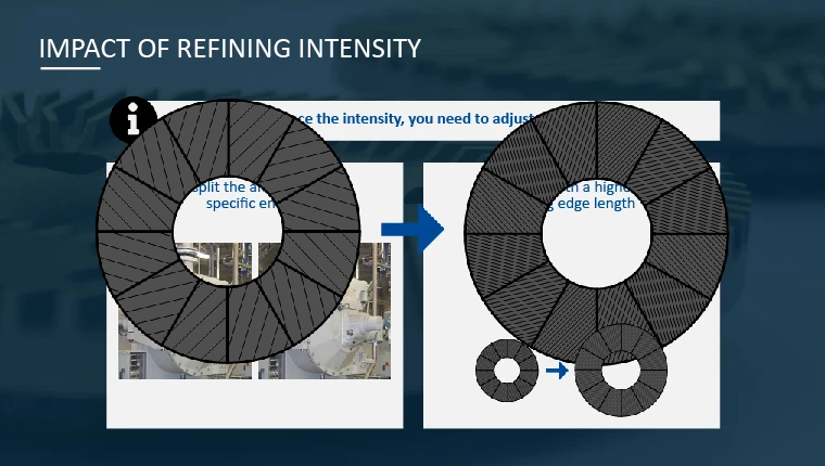

In the current project I'm working on I experiences some strange behaviour of SVG objects. Most of the illustrations I'm working with, I create in Illustrator, save them as SVG and import them into Captivate. Once I place them in the slide, I resize the objects and put them at the right position. After saving, closing and reopening the project, everything seems to be normal at first. The slides look fine from the small thumbnail in the film strip, but once I click the slide, the SVG objects on the slide will change without me doing anything. I have really no idea what is happening and it causes a lot of extra work. Does anyone expierenced something similar before?

    Can you be more specific about what 'changes' you are seeing?  Perhaps show screenshots so that we can actually see the changes?
    Aug 10, 2020 7:07 AM UTC
    Size and position are changing. Most of the time the object will resize to the original size and placed in the center of the slide.
    Here for example the object on top should have the same size as the object below and should be placed in the right box.

    Is this a Responsive Fluid Box course?
