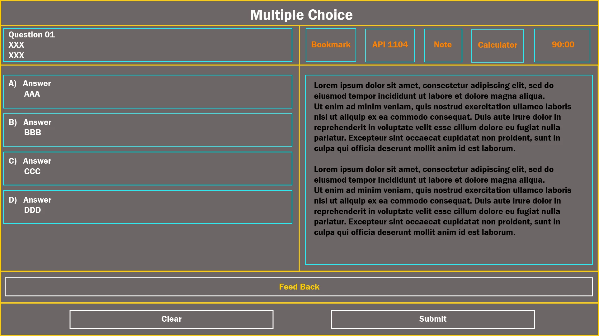

The last big picture necessity is that their students are able to see the question and answer choices alongside the measurement tool without having to click back and forth between tabs. We have preliminarily solved this by intending to create the Captivate file (and Multiple Choice Master Slide) with dimensions of about 1920 x 1080, with the question and answers on the left, and all reference materials and tools to display on the right programmed to buttons to display/close them. Ideally the image and measuring tool would be contained within the proper Fluid Box (in template attached, it's FB below the buttons on the right with the placeholder text). However, we recognize that this might not be possible and would be open to a popup window, iFrame, etc if necessary.
