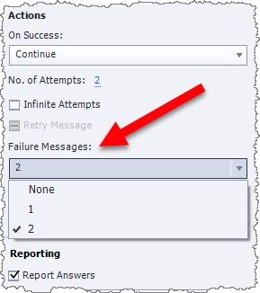

    There is a way to achieve this without resorting to Advanced Actions or using the Advanced Answer option.
    If you set the number of attempts to 2 (as Lieve suggests) you will then have the option of having 2 Failure Messages. (Three attempts would give you up to 3 failure messages, but that's the limit.)
    Just customise the text of the second failure message to give the necessary information to the user.

    SInce the first attempt should have a Retry message, I did not propose the two failure messages, thought the Retry message was what OP needed.

    Is it a MCQ with one correct answer or with multiple correct answers?
    In the first case you can use the Advanced Answer option.
    Anyway you can have a Retry message, which will appear after the first attempt if it is failed. The Failure message will appear after the second, last attempt. Is that not what you want?
