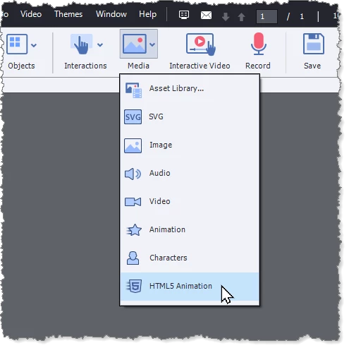

    Captivate has two types of widgets.  If the ones you are looking at have SWF at the end of the file name then YES they are definitely Flash files.  Do not use them.
    Captivate has shipped with HTML5 Learning Interaction widgets for several versions now.  You should be able to see the HTML5-compatible widgets listed under Media > Learning Interactions.  These ones are all OK to use.
    As to whether these widgets are fully responsive, the answer is usually NO.  They are normally designed for use on non-responsive course layouts where the screen size is fixed.
