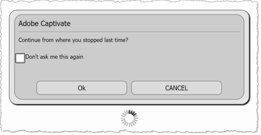

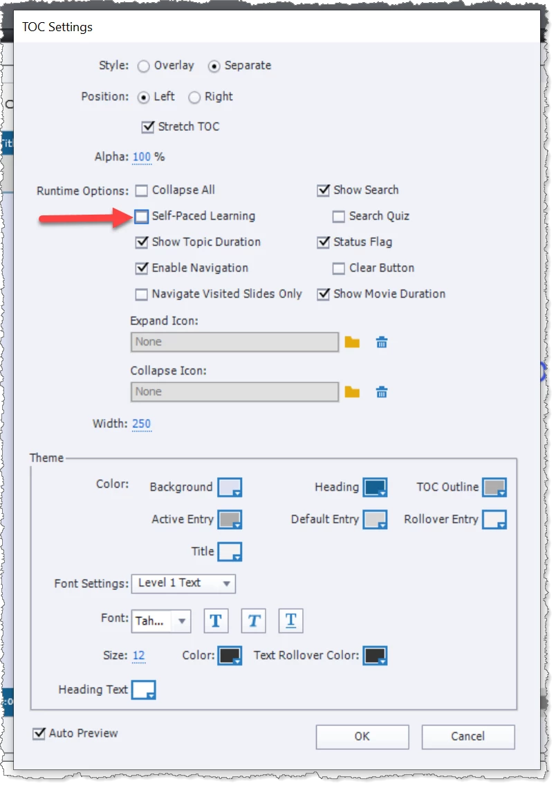

    What you are talking about here (coming back to resume a lesson at the same place) is referred to as 'bookmarking'.
    Captivate has two methods of bookmarking:
    • Resume Data Bookmarking is turned on in the Quiz settings and is ONLY used for situations where the content is being delivered from an LMS.
    • Self-Paced Learning Bookmarking is turned on in the Skin Editor settings and is used for NON-LMS situations.  To turn it on, ensure that this checkbox is selected.
      If it is working, your learners should see this dialog when resuming their lesson.
