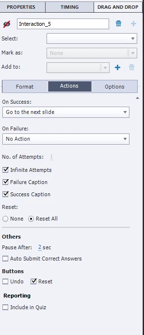

    You are using the Failure caption (shape)? That doesn't give you much control but you can select that Failure message, and change its duration from the default 3 seconds in the Timing panel to what you want.
    If you really want more control you could use the Failure action, but that means you'll have to limit the number of attempts to 1. Is this D&D set up as question or just as Knowledge Check?

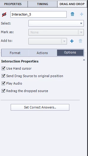

    Can you give details how you did set it up now?
    August 13, 2018
    Here are the screenshots. Is there some screen I am not seeing?
    Thank you as always.
