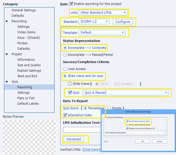

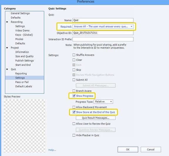

    Correct answer kumard312279
    Use this settings
    kumard312279Correct answer
    March 20, 2017
    Use this settings
    Cher0311Author
    March 20, 2017
    Thank you Kumard312279!
    Unfortunately this is a vendor's file so I can't adjust it immediately and let you know the results.  HOWEVER I am passing this on to them ( I asked them to set it as you have it in the first screenshot BUT I didn't go into the settings tab...so this is new )
    As soon as I have the new file from them I will let you know if it was successful.  I really appreciate your help.
    Sherrie

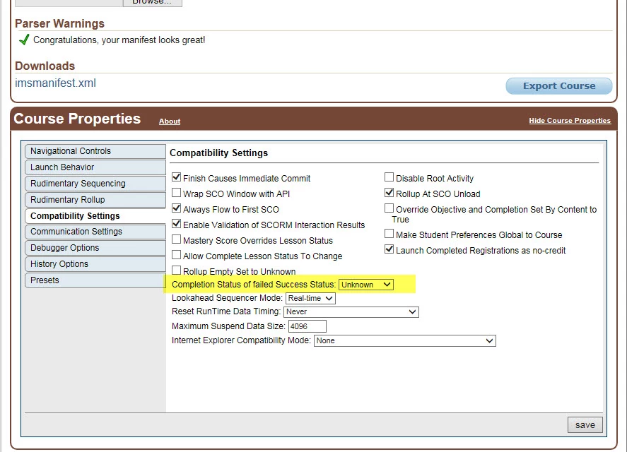

    Do you get the same error if you upload the same SCORM package to SCORM Cloud online LMS to test?
    Cher0311Author
    March 20, 2017
    Hi Rod,
    When I loaded it to SCORM cloud it said my manifest looked great.  BUT when I dug in a bit I noticed the highlighted dropdown (in the picture attached).
    Are you familiar with that?  Since it is not completing in the LMS do you think that is the issue?  My client used an outside vendor so I don't have the captivate file to look at, I am trying to get it from them, but not so sure they will share.
    Thanks for any additional thoughts you might have.
