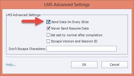

Correct answer Erik Lord
'Send Data on Every Slide' should do what you need. If nothing else, CP should send 'resume data' (since you don't have 'Never' checked' on every slide.
If Send Data on Every Slide is indeed only applicable to slides that send interaction data (which would surprise me), then you could possibly workaround by including a Next button on every slide with a value of 1....so that score would have to be sent to the LMS.
However, that will surely throw off your actual quiz score.
May be worth a try just to see if that solves or proves the issue...
How can you be sure the Send Data option only applies to quiz slides?
Cause if you look at the Configure button options next to SCORM 1.2...that has a 'SendTrackingDataAtEnd' template which is exactly for sending all data at the end...so that implies with the 'Default' template that data is sent throughout, not just for quizzes...

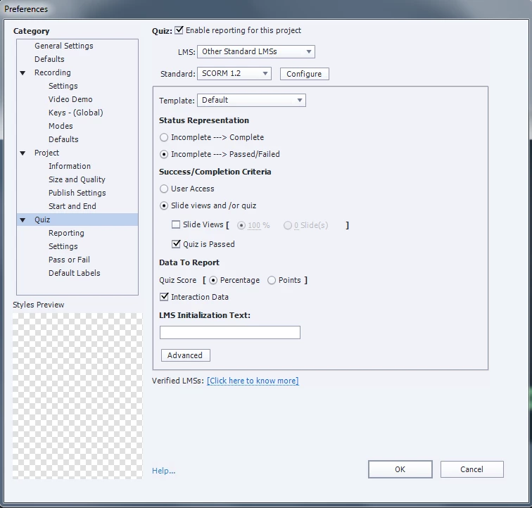

Can you post the Reporting settings?
July 11, 2016
Here's what I'm currently using

Erik LordCorrect answer
July 12, 2016

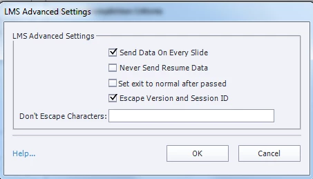

July 11, 2016
HI Hannah,
have you tried to check "Send Data on Every Slide" checkbox. Perhaps this can keep the session alive and solve the problem.
July 11, 2016
Thanks for the suggestion, sorry I should have mentioned that I've tried this already.  It seems that this only applies to quiz slides (sends the score slide by slide rather than all at the end of the quiz).
