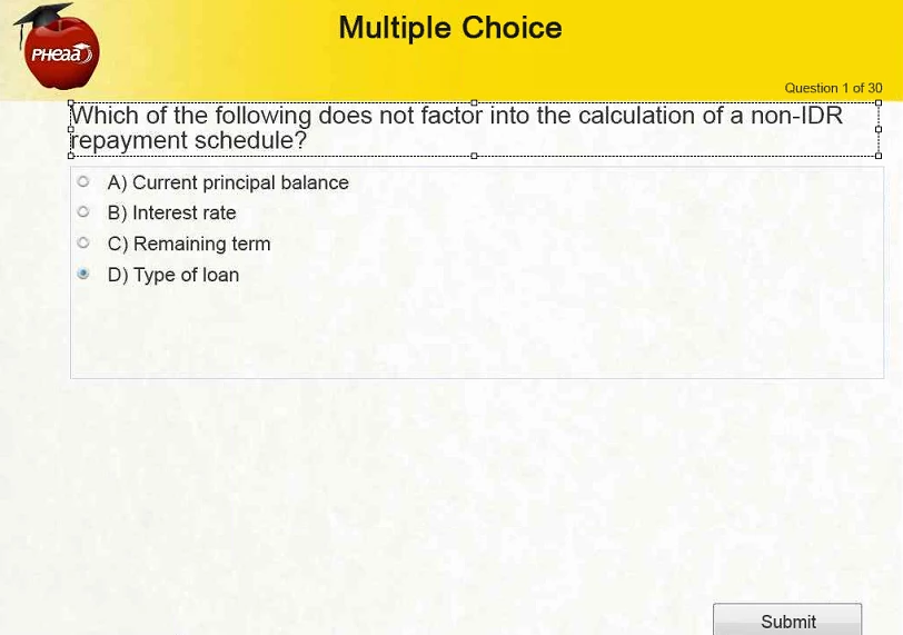

A coworker has created a basic quiz in Captivate 8 (MC/TF).  We use Skillsoft as our LMS provider and when we run SCORM reports on her courses, some of her questions report as the default text in Captivate (i.e. insert question here) rather than the actual text in her questions (see example below):
This is how the question appears in our report:
M4A_Q1_Type_the_question_here
When it really should include the text from the above image.  This only behaves like this for certain questions, as others (which are much longer) report perfectly fine.
Example:
M4A_Q2_Which_of_the_following_Federal_regulations_applies_to_Standard_(Level)_and_Extended_Standard_(Level)_repayment_plans_
What could be causing this behavior? I had her save before publishing out of Captivate and test again, with the same results. I'm having her create this from scratch in case anything was corrupt, but this is causing a huge problem for her. Any advice?

I had the same suspicion as Rod, that the developer has not used the normal placeholders for the embedded objects, those without an individual timeline in master slide/quiz slide.
RodWard
Feb 8, 2017 1:18 AM UTC
The Question Title and Question Text captions might look like normal captions but they are actually special objects that only occur on quiz slides.
Is there any possibility that your developer may have replaced the default Question Text caption in these malfunctioning quiz slides with a normal text caption?
The way to tell is to see if there is a line item shown on the timeline of this particular quiz question slide that relates to the question title caption.  If there IS such a line and you can hide that question caption then it's NOT the original default one from the question.  If you confirm this situation then you need to delete this question slide and replace it with another one that has all the bits.
