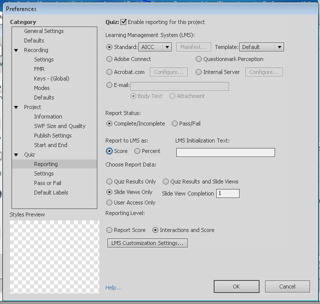

I've never used Captivate before, but we have a course in our LMS that was made in Captivate that isn't marking users as completing the course after they complete it.  We are using Captivate 5.5.  I went in to change the reporting properties and saw that it was set to mark as complete after 95 slides were viewed, so I figured that was the issue since the project was only 40 slides.  I changed it to mark complete after 1 slide was viewed (for the sake of testing), but it still doesn't mark as complete with that property.    Here is what my reporting properties look like at the moment:
Has anyone else had this issue?  Or is there something simple that I am missing?  Thanks!

Is there any reason why you are using the AICC standard? Maybe try switching it to SCORM 2004 or SCORM 1.2 and publish/test that way.
Amanda J Hiatt
March 27, 2014
Switching it to SCORM worked.  Thanks for your help!
