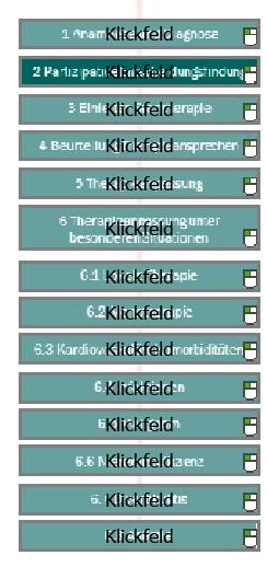

Basically i have imported a very big powerpoint file from my client into a responsive captivate file.
All i want to do, is to rebuild the interactive buttons from the original powerpoint file.
So i started setting up buttons and making them just jump ahead to the according chapter.

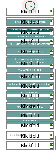

My issue now is that when i scale down the resolution, and preview the file on a smaller screensize, the buttons i have set up scale down inappropriatetly, everything shifts and everything gets unaligned
Is there a way to fix this behavior?
I have added two pictures to showcase my issue better

    Why not use a non-responsive project which you publish with Scalable HTML feature checked? In that case you don't have any limitations, you can use click boxes on top of images or shapes, but they still will scale down and up. Sorry, but I never use PPT to start a Captivate project, and certainly wouldn't even dream of trying this to become a responsive project.  If this was a CP project, you wouldn't need click boxes, because you could use rectangular shapes as buttons. Your problem is that you only have a global static or video slide, no individual objccts from the PPT import.

    Can you explain how you made a responsive project without using fluid boxes? Logically that means that you never will have a responsive project, unless you used the older Breakpoint views workflow?  You probably have only a scalable HTML non-responsive project?
    Moreover, if I am correct, you did add click boxes on top of images, but click boxes are only allowed in static fluid boxes. At least if 'Klickfeld' (German) is the translation of a Click box. First practical tip: avoid using stacked objects if you want the project ot be responsive.
    If this was a unique slide (not a long PPT deck) you could use Position Properties to set up this slide, which is similar to the way that panel is used in Breakpoint views workflow.
