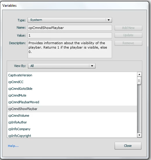

    I am not sure if you would like to hide it or lock it.
    I can recommend you to use the a system defined variable and set it to hide the play bar on ceratin slides so it would not appear on those slide.
    Thanks!
    Anjaneai

    Thank you so much for your reply.
    I think I can hide and show the progress bar now.
