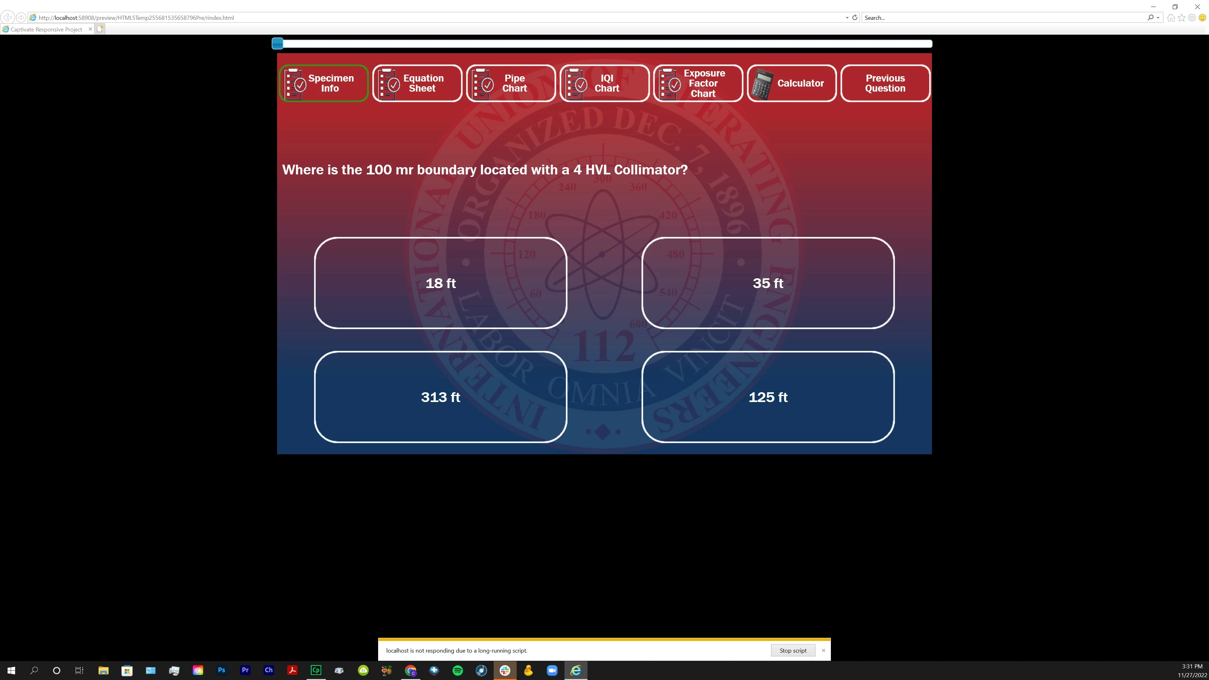

A SME was unable to complete a SCORM 2004 3rd Ed file, so I first replicated the issue in the LMS (Adobe Learning Manager). Next I went into Captivate and looked at the slide where he discovered the problem. The slide itself does not have anything unexpected in its objects, actions, etc. that would cause the issue, which is simply that when all of the 4 buttons with answers in them are not executing the "Jump To Slide" action they're all assigned (navigating to 4 different slides for particular-mistake-specific remediation).
I removed all pauses from buttons, and rearranged slide orders to utilize the "Go To Next Slide" action instead of "Jump To Slide," even though neither should matter in theory. FINALLY, after a dozen guesses (and previews of the project) at different things it could be, I clicked the button with the correct answer in it (which is triggering all objects not be able to be clicked any more) and sat in frustration for about 30 seconds racking my brain when the attached screenshot with its error message at the bottom of the screen came up that reads "localhost is not responding due to a long-running script" and gives me a "Stop Script" button. When I clicked Stop Script, it jumped to the proper slide and all worked well.
I'm no developer, so I don't know what could cause this, but I started trying to locate a root cause within the Captivate file by Previewing "From This Slide" at each of the sections of the material and working backwards. The previews ran perfectly up until I was previewing the entire Project. The same issue happened when I used the Preview Project, as well as when I previewed "From This Slide" while highlighting Slide #1.
I then deleted Slide #1, which was largely window dressing, thinking that the slide was corrupted for one reason or another. When I previewed the Project, I ran into the same problem on with the long running script.
Assuming that the long running script is causing the same problem in the Captivate Preview function as it is in the published SCORM files (without the error message coming through), I am at a loss on how to resolve it, especially since we used the same template for many other SCORM files of identical design that are working as expected in the same LMS.
Any ideas or experience with this would be much appreciated, thank you in advance to anyone that can help!

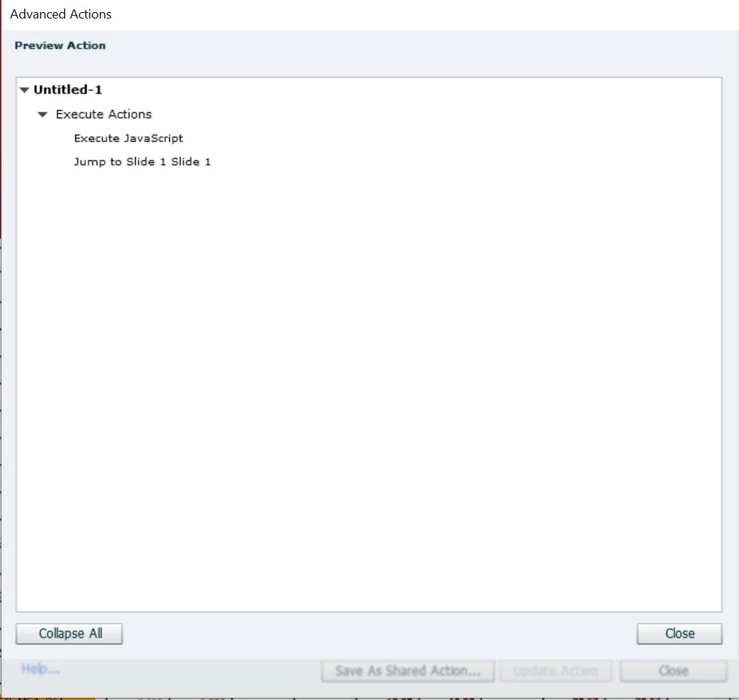

    The Preview window of an advanced action (as Rod and myself would like to see) can be opened using this button:

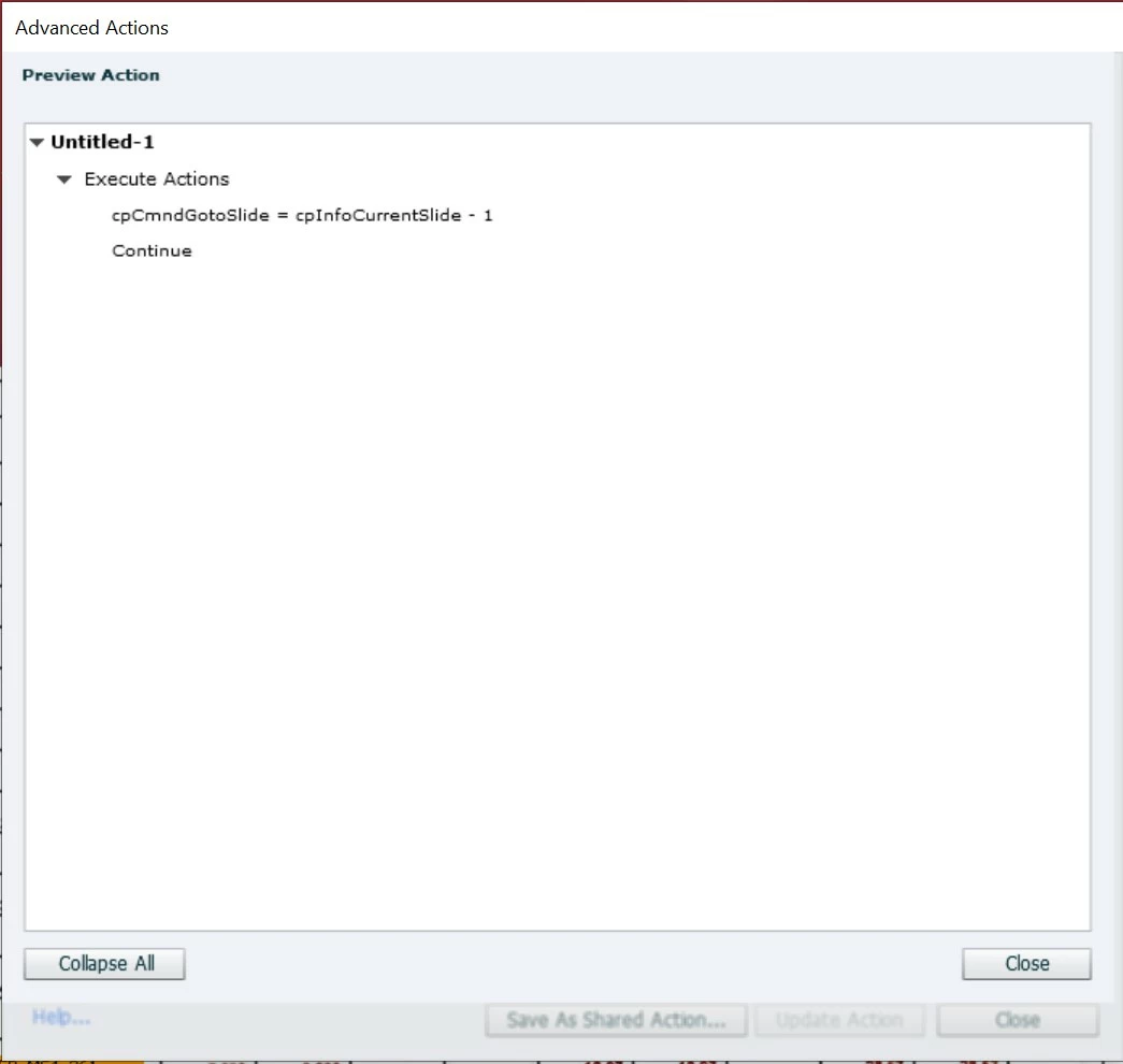

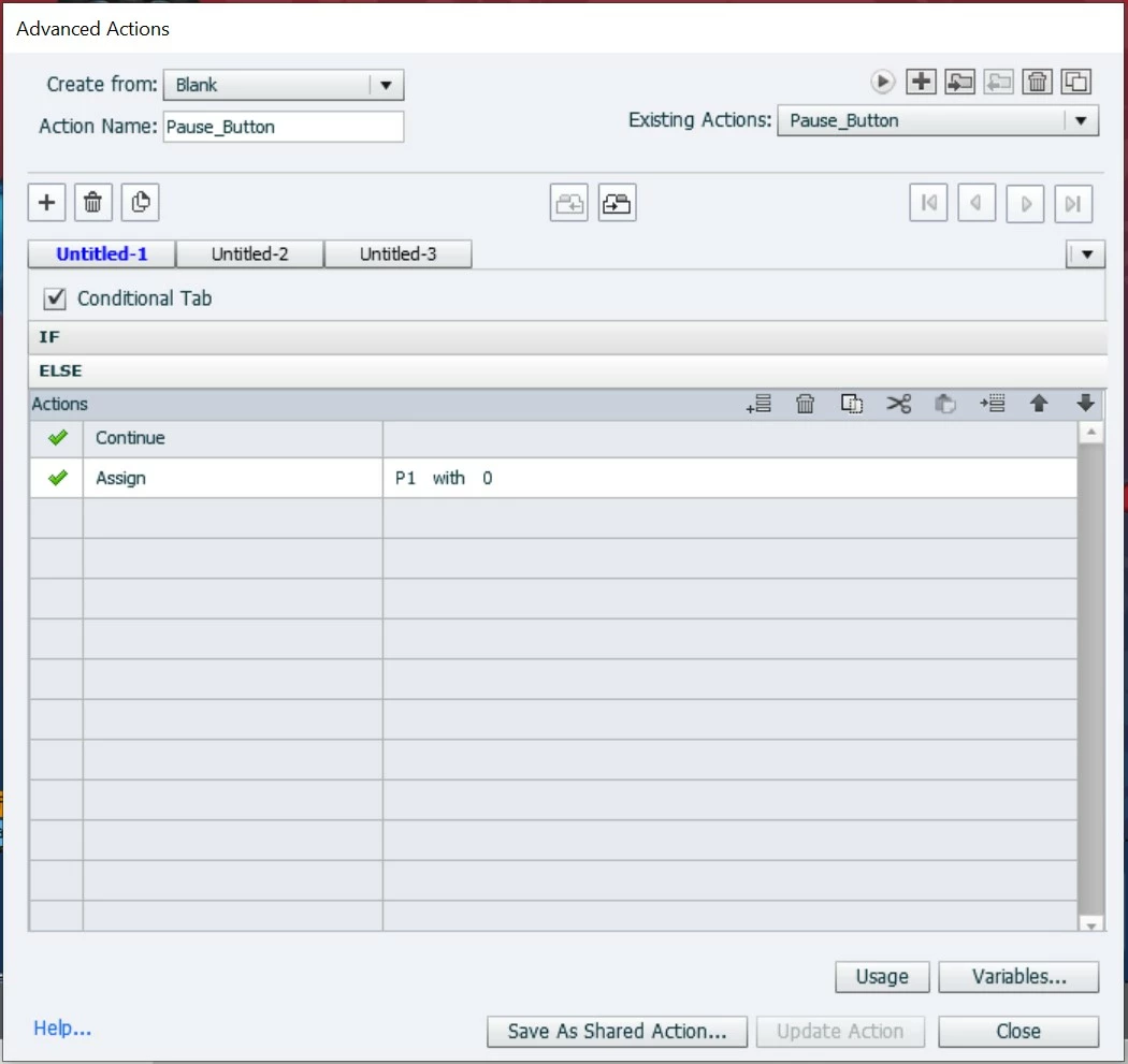

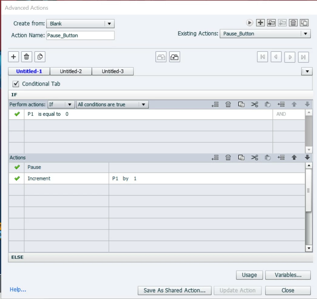

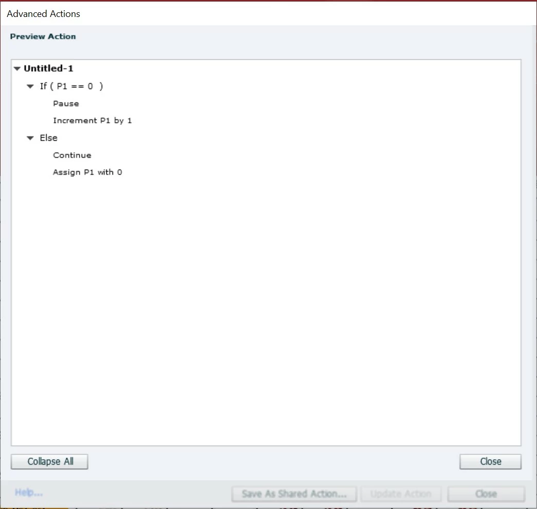

    Hi @Lilybiri , thanks for the reply! I'm definitely part of the 90% ignoring AA dialog box features... and even ignoring @RodWard 's request for that info (by accident). Here's all the info requested:
    -Captivate Version: 2019 Release 11.8.0.586
    -Project Type: Responsive and using Fluid Boxes (haven't used Breakpoint views before)
    -AA Previews:: Screenshots attached. The only Conditional AA of the 3 is the Pause_Button AA.

    I have seen your Toggle conditional action before (probably in another thread), even offered a link to my Play/Pause button tutorial.
    The ReplaySlide action will not reset the slide, but maybe that is not necessary.  The RetakeChapter has that famous JS command  which caused you problems in the other thread. Do you need it?
    To see the full picture of the problem slide, can you post a screenshot of the expanded part of the Advanced Interaction panel for that slide? That way we can see which actions are triggered by which events.

    @RodWard Thanks for the reply. There are no Conditional Advanced Actions being executed on the slide (screenshot attached).
    For the slide in question (Question 13), the On Enter Action  and Exit Action are both "No Action." Basically, we're waiting for the student to choose an answer, which works on 12 identically-setup question slides... Unlucky #13 is the problem child!
    In the Slide Objects screenshot, the 4 large answer choice buttons and the Previous Question button (top Fluid Box) all have an On Success Action of: Jump To Slide [X]. The slides that the answer choice buttons jump to do not have Advanced Actions being executed, they are all set up with On Enter: Continue and On Exit: Pause.
     All buttons in the top Fluid Box (except for the Previous Question button) have an On Success Action of: Execute JavaScript with a script window similar to this one (Current Window😞
    window.open("https://abc123.com/practice/id_code/Chart_1.pdf", '_blank', 'height=500,width=1080,scrollbars=yes,resizable=yes');
    On the Question 13 slide, these buttons pull up the proper PDFs until one of the answer choice buttons is clicked, which is when all freezes for 30 seconds or so before the long script error message appears.
    The only Conditional Advanced Action in this file is a Pause_Button AA (screenshots attached), which is not used on the slide in question (only remedation material slides). In all of the testing completed today, I never once triggered the Pause_Button AA.
    If all that doesn't add up, is there anything else that can cause this error message?
