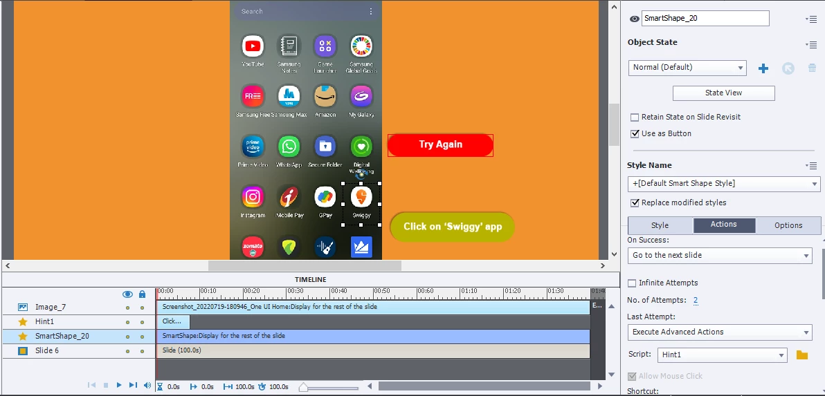

I am working on a e-learning module, wherein, if my learner clicks incorrectly twice they should get 'Try again message. After 2 incorrect clicks it should give them a pop-up of hint with correct answer. I've tried using smart shape as a button and added 2 attempts in action and then show the hint box shape. However, when I preview it, it's working sometimes and sometimes not working. Even after publishing it in HTML file same issue persit and after 2 try again it lags for a second/two for hint box to appear. Is there anything else I can do, please help.

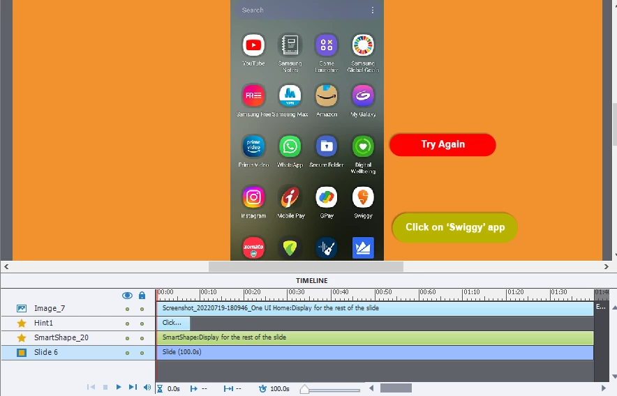

    About your present solution, could you post a screenshot of the slide timeline and of the Actions tab of the shape button?

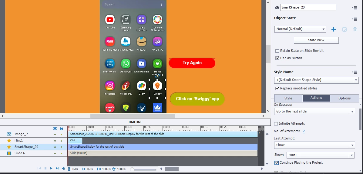

    Yes, if you can help and write the steps will be a great help. Sharing the screenshots.

    I tried show option and advance action as well. However, in both cases during preview my hint shape would lag to come-up or work all the time.
