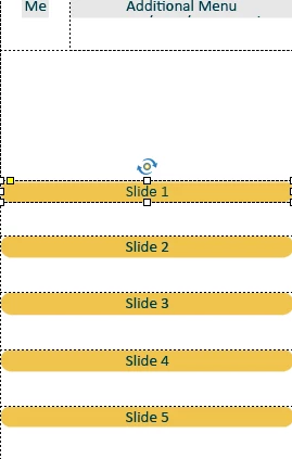

I'm building a responsive course, and I'm trying to create a menu overlay slide that will show for the rest of the course.  I have 5 buttons stacked vertically at the bottom of the slide.
The menu button toggles the buttons off and on, so that people can view the main content area and not have the navigation interfere.  Easy-peasy, right?

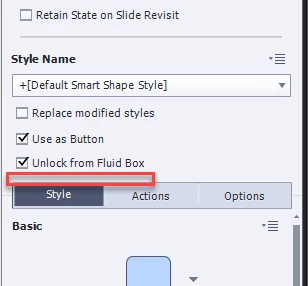

So originally, I had the buttons set to maintain aspect ratio, so they would stay big and easy to tap, no matter the size of the screen.  However, when I set the button to display for rest of project:
Now, the maintain aspect ratio box disappears,

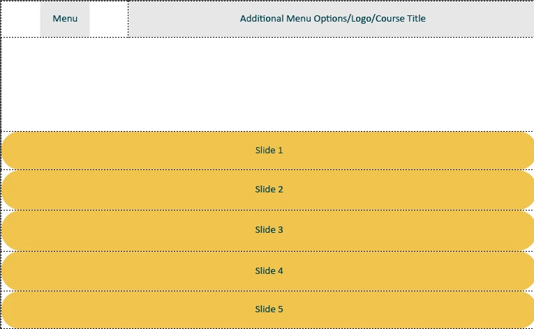

and when I go to resize the project, this happens.  My beautiful aspect ratio is destroyed!
Why is Captivate so determined to prevent me from doing anything nice with it?  Does anyone have any tips on how to make this work again?  Is this supposed to work this way, or is it a bug?  I'm trying to wrap my head around why this functionality would be disabled when the slide is set to show for project?  It makes no sense to me.
UPDATE:
I tried rebuilding this slide in the master slides, with even more horrendous results:
Now, for some reason, the menu button just advances to the next slide, even though there are NO instructions for it to do so, and the buttons are all over the place and all random sizes.  Is this a bug, or is Captivate seriously just not equipped for this kind of stuff?
UPDATE TO MY UPDATE:  By the way, once you make the maintain aspect ratio box disappear, reversing my directions does not bring it back.  If you make it go away, it is gone forever.  That must be a bug, right?
