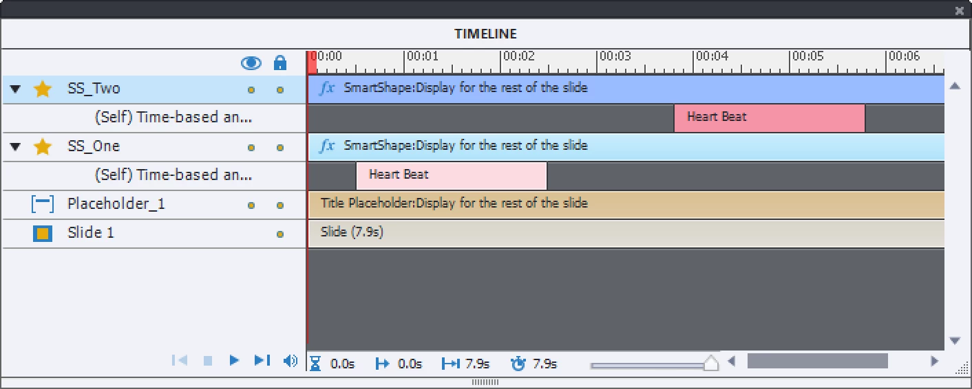

    Sue, you can add effects to an object in Responsive projects as well, at least in CP9 (don't have 8 on this system). The Effect timeline will appear under the object (there is an expand/collapse button). You can drag the effect on its timeline to the time where you want it to appear in synch with the audio.
    In this screenshot (sorry, forgot to insert audio), I applied the same effect to two shapes. The effect is from the category Emphasis, it will play on the first shape at 0,5secs, duration 2 secs. The effect on the second shape plays at 3,8secs. Both start time and duration can be set either in the Timing properties, or by dragging, or with shortcut keys.
    In CP8 the Effect timeline is still in a separate window, but the timing is possible there as well, just different.
