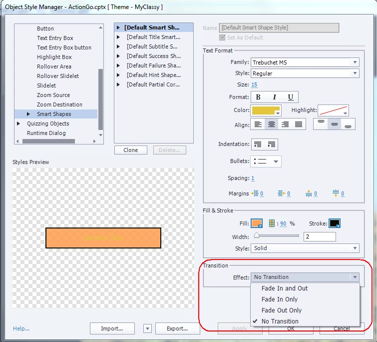

Did you check the object styles? Is this a project created originally in this version, or did you upgrade anything? In previous versions Transitions were default for a lot of objects, that is the reason I asked to check the styles.
Slide transitions are not supported for HTML output, that cannot be the reason.
Since it happens always on the same slides, you really should check the Transition possibility for the objects. On Slides you find it in the Timing properties.
Lilybiri
July 28, 2016
Can you check the styles in the Object Style Manager for shapes (since you put the buttons on the master slide, they have to be shape buttons)? Maybe by default they have a Transition, a Fade out effect?
