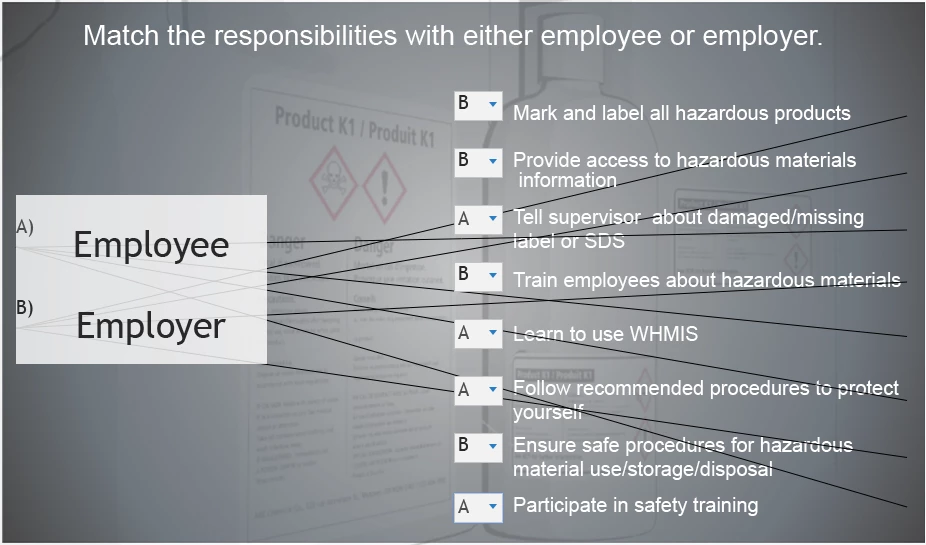

Matching (Knowledge check) slide lines continue past answer.
  • October 2, 2018
  • 246 views
Has anyone run into this before? I was editing an existing project in Captivate 2017 and suddenly one of the matching slides started doing this in SCORM preview and HTML 5 in browser. I rebuilt the slide from scratch and I'm having the same result. The image below depicts what is happening. I know removing some of the knowledge check slide boxes like "Question title" and "Question" can cause glitches. They had been deleted from the original so I hoped that would solve my problem but I haven't had any luck. Any help you might be able to offer would be much appreciated!!

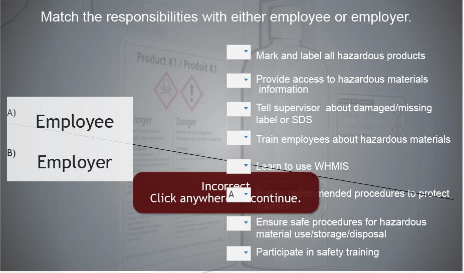

    The correct/incorrect/try again boxes also appear under the matching questions. As seen here. I am very confused as I know of know to control how close to the front theses boxes sit.

    Did you check what has been deleted as embedded object on the master slide? I suspect that to be the reason for the problems. The alignment has always been a pain, try playing with it in the Properties panel.
