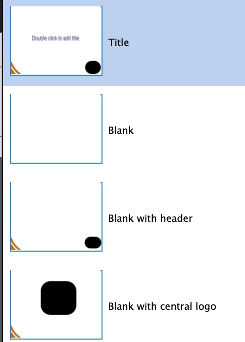

    Thanks for your note. It is a template, not a theme and it is a master slide that someone made when they created the template and just called it "Blank with header":
    I'm trying to use the Drag and Drop Matching QSP slide in a non-responsive project. What I need/hope to do, is put the drag and drop matching interaction (rather than make it from scratch as I'm in a bit of a hurry) on an approved branded slide. I don't want to use the matching question because those little lines get really busy and are quite annoying.

    ;;;;I cannot help you with a cptl file (template) because those cause too much problems as I already mentioned in my article where I explain the main differences between both. Have no idea if they used placeholders, placeholder slides or even advanced actions and variables which are the main culprit of problems with template files.
    What you show me points to a theme, because master slides are one component of a theme. Very weird that those are all called 'blank...'.
