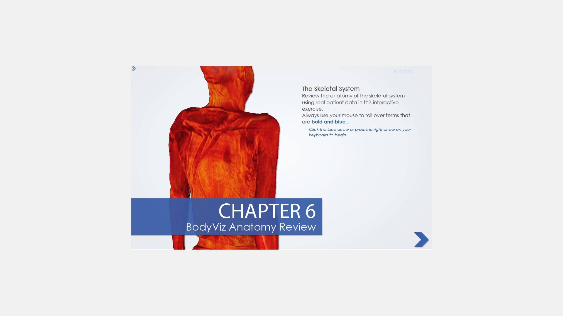

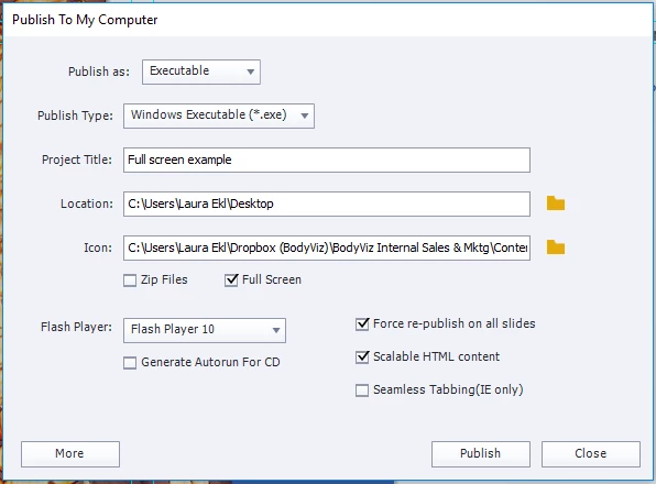

RodWard - unfortunately, when I select that option, the window can be maximized but the active are remains the same size (screenshots below).
Libibiri - thanks for your response. I know that checking 'Scalable HTML content' allows the content to resize when it's imported into an LMS as an HTML5/SWF project. It doesn't seem to help me when the file is published as an executable. Do you mean that this only works when the file is published as HTML?

If you want the EXE to be full screen, you need to select that option checkbox when you publish the EXE.  It's on the Publish dialog.
