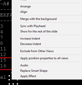

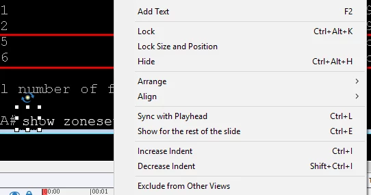

    April 18, 2016
    I am currently at verson 9.0.0.223 of Captivate. I don't have the master slide selected here, only a single slide in the project. I am attaching an example... in the Cap1 example.... the black shape is right clicked... (note that merge is missing). Then, I moved it up slightly using the tab key and right click once again.. the merge is now visible.
