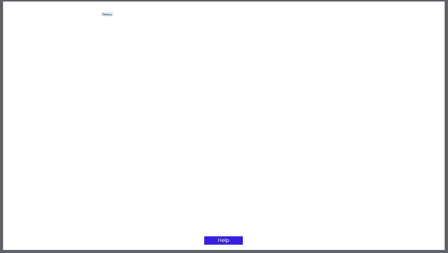

P.S. For the Adobe developers, When I select the Background as the "Master Slide background", its white - as it should be, except for a blue square the same shape and size of the tab in question with the tab name on it. It seems to be stuck in that position. If I view the master slides menu - it only has a white slide with no blue square. I only see it when changing the background to that master slide.

    Yes, I understand the background is replaced by a slide background which is captured. I am not really using a custom theme, more of a blank theme. The Master Slide is a blank white screen, which is replaced by the screenshot as i create the simulation. However as advised earlier, when I select the blank white screen as the master slide from the properties panel, there is the tab showing by itself. This shouldn't be there, which leads me to believe it's a developer issue, rather than a user issue. I did find a workaround, which I will explain in another reply.
