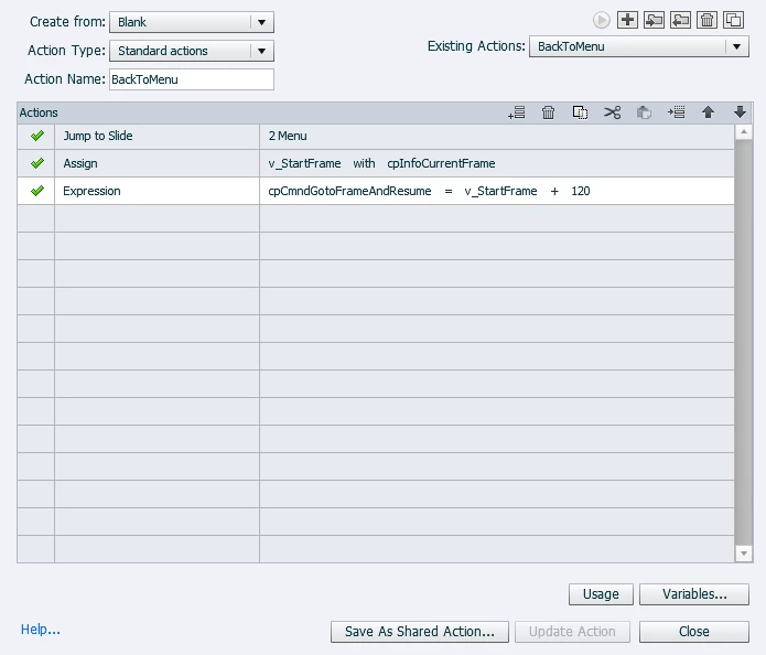

I am trying the following as an advanced action attached to the button at the lasts slide of a section.
I have a user variable called Current slide where I store the cpInfoCurrentFrame
Jump to Slide => The title/menu slide
Assign - CurrentFrame with cpInfoCurrentFrame
Expression - cpCmndGoToFrameAndResume = CurrentFrame + 120
What happens is that the user is brought back to the Title/Menu slide, but it starts from the beginning.

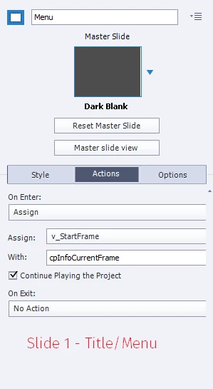

1. Lets say that I have only two slides. One is the Title/Menu (with the Video). The second slide has a Next button with the AA attached.
2. I have a variable called v_StartFrame.
3. This is what I have as action on Enter of the first slide (Title/Menu)
4. This is the action that is assigned to the Next button of the Second slide.

Anyway the second command (Assign) has no sense in this setup, because you are re-entering the title slide, and that means that the On Enter Assign command has already been executed. Is this really the first slide? Because in that case you don't need to store the first frame number.
