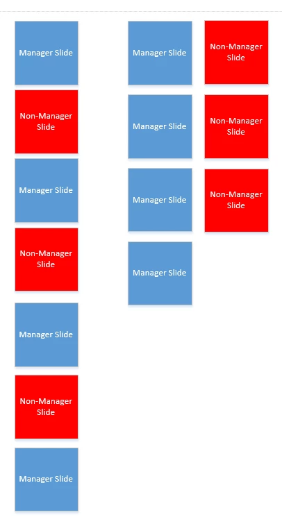

Turns out when I had the manager slides in one group and the non manager slides in another group, and I removed the jump to slides and replaced them with Go To The Next Slide it fixed the problem.
I should not have had a Manager Slide then a Non Manager Slide in the first place. All the Jump To Slides caused Captivate to freeze. There simply were too many Jump To Slides.

If I grouped the duplicates into one section and the other sections into one group and had the button go to next slide do you think that would stop the issue of the slides slowing down?

Do you think it might be due to the fact that I have so many duplicate slides? One for manager and one for non manager?
If you recall from my previously long thread, I was doing branching. I have to do the duplicate slides because I am not up to speed with the advanced actions.
I am making great progress, but even if I were to get it right I have to be able to hand this project off to someone in the future, and they do not know advanced actions.
So my question again is, do you think it's due to the multiple slides? I don't see why it would be. Each slide has it's own Jump To Action.
