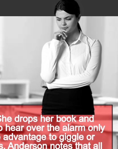

I am noticing that after I publish my course and share through SCORM Cloud that some objects are misaligned on some of the slides. But when I go back to the course and preview in the Captivate App, all is fine.
I don't want to share a messy finished product so I'm curious if anyone has come across this issue and have advice on how to remedy it.

    Sep 12, 2020 6:31 PM UTC
    Captivate 2019. 11.5.1.499. OS is Windows 10. I believe I selected responsive project, but not sure how to verify (it's been a while since I began the project). The preview versions that show everything fine are "Preview to Devices" and "Preview to SCORM Cloud." However, as I note above, when I zip and publish to SCORM Cloud as a URL invitation, several objects are out of alignment. See screenshots for a couple examples. You may view the course at https://cloud.scorm.com/sc/InvitationConfirmEmail?publicInvitationId=1a6c525d-4418-4f1a-812e-ed89439897e7

    It is indeed a Fluid Boxes project, visible from the Publish option you mentioned.
    I can only suspect something to be awry with the Fluid Boxes setup, which is difficult to detect without seeing the file. Check if all items are dimmed in the timeline, which proves that they are all in a fluid box.

    What type of project are you creating? If you are using a responsive project with fluid boxes and are not unlocking objects from the fluid box, make sure that you don't have "maintain aspect ratio" enabled because otherwise Captivate will do this and left/right alignments can go awry. This caught me out. If you are not using fluid boxes and are using the align toolbar to align objects it should be fine. Remember also that the Captivate preview in the app is an approximation and you are doing the right thing by checking in SCORM Cloud.
    Sep 12, 2020 6:24 PM UTC
    I believe that it is a responsive project. It's been a while since I began it, but "Save as Responsive" is not available to me, which I believe means it is already responsive. Is there a way to check?
    None of the objects in my project have been unlocked from the fluid box and I confirmed that "maintain aspect ratio" is not enabled.
    I used the preview in SCORM Cloud option and everything looked fine, but when I zip and publish to SCORM Cloud as an invitation for reviewers, several objects are still misaligned. See screenshots in thread below.
