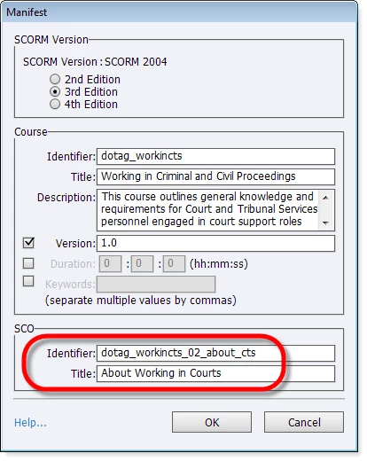

    Here is my Manifest dialog settings:
    Note that what I'm expecting to see in the TOC of the LMS SCORM Player is the Title field name of the SCO (About Working in Courts in this case).  But what I'm seeing appear is actually not that field, and it's not even the SCO ID field above it.  (I tried changing that field as well to see if its value was what ended up getting written into the imsmanifest.xml for the multi-SCORM package.)

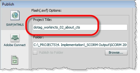

    What ended up being used as the Title of the SCO in the package turned out to be the contents of the Publish dialog's Project Title field.
    I verified this by changing the values in this Project Title field for a couple of SCOs, published them to zips and then compiled them into a Multi-SCORM.  THEN  I was seeing those values in the TOC of the LMS player.

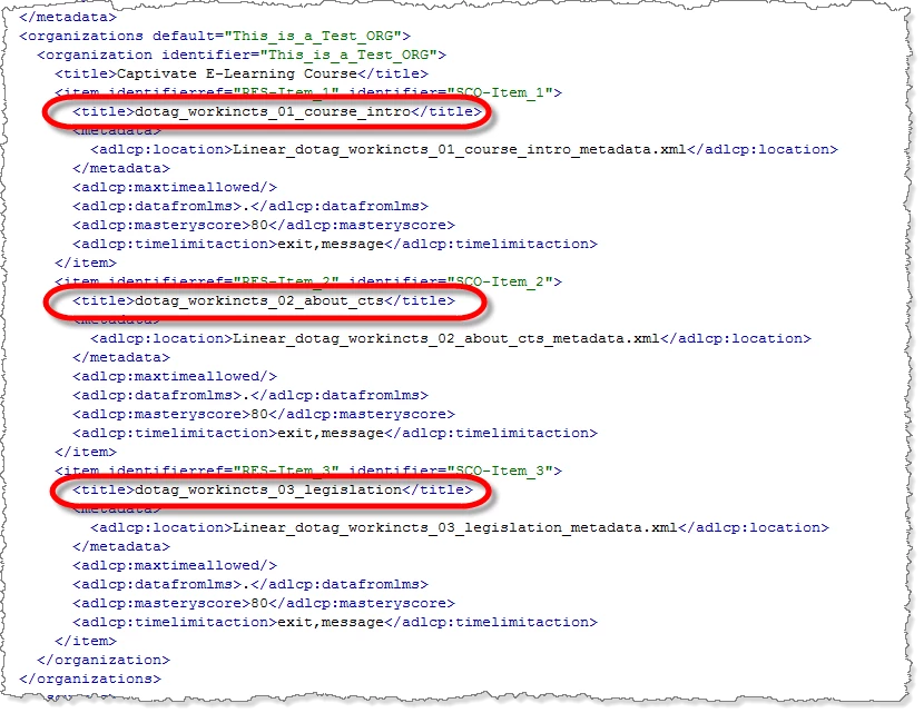

    Currently, when I create a Multi-SCORM Package with the Cp7 app, here's what I see in the Title tags of the Organizations block:
    As you can see above, what's coming out is NOT the SCO Title tag value from the Manifest dialog, and although it looks similar, it's not the SCO ID either.  The value is in fact taken from the Publish dialog's Project Title field.
