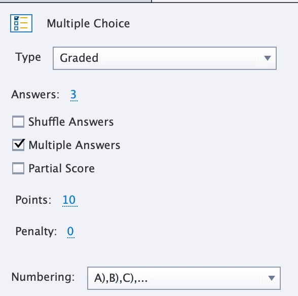

    I mentioned the system variable you'll need in my first answer: cpQuizInfoAnswerChoice.  After the submit process it will have the value corresponding with the chosen answer. For each of the possbilities you can show a state of the feedback multistate text container.

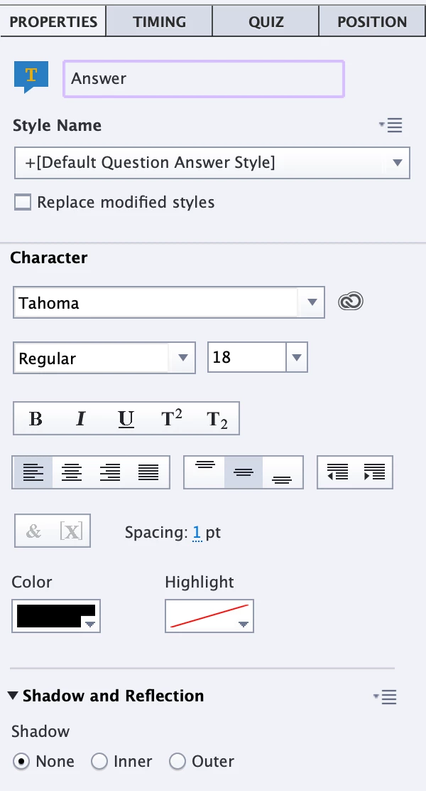

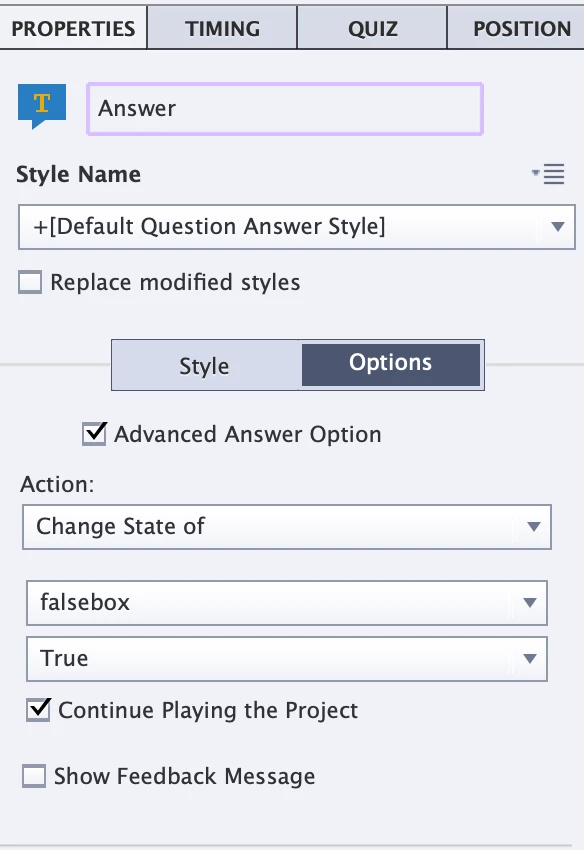

    This is what my screen looks like for a single answer multiple choice question (This is a multiple choice question not custom question)
    As soon as I change it to multiple answers, this option goes away, this is the same question with the multiple answers toggled on and off.  There is no options panel to change the state of.
    The toggle I am changing, check marked below.
    How do I determine the correct variable for each answer on this page?   I am ok writing the advanced actions to get what I need if I know the variable names.

    OK, you posted something similar already, right?
    You mean that you cannot use the Advanced Answer option in this case, which is not really what is written in your question. The answer in the other thread given by both Rod and me was that you don't have the Advanced Answer option for a MCQ with multiple correct answers, nor for any other type of question. It only exists for MCQ with one correct answer.
    It can be done here, but you'll need to be comfortable with advanced/shared actions. Are you?
