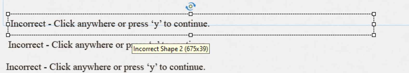

    You need to choose 3 (which is the maximum) number of Failure messages.  Three Failure message boxes will appear on the slide, but it may be difficult to see them because they can be stacked. You will need to uncheck temporarily most other messages, and to some moving. Here is an example screenshot, where I took out the Retry and Correct message temporarily and moved the three Failure messages. You need to hover over the message and will see if it is 1, 2 or 3.  Edit the messages as wanted. If you have more than 3 attempts, the third one will also appear at the 4th and later attempts:

    This is for a non-responsive project. I'll try shifting them around so I can see all three, but it just seems to me the changes I'm making are not sticking. Again, maybe they are stacked as you say. I'll try it and see what happens.
