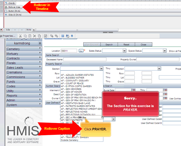

    I think there is an easier way.  I haven't created a project with multiple rollovers, but it should work the same.  You don't need to create a new slidelet - just use the rollover feature.  Create a rollover for each object you need.  Then when you are inserting the audio, make sure to add it to the caption rather than the rollover object on the timeline.  Does that make sense?  Here's a screenshot to illustrate:
    You should be able to have multiple rollovers on the same page and have them all appear on the timeline at the same time.  When the user moves the cursor over the rollover, the audio will begin.  The only caveat when using the rollover is that the user must continue to keep the cursor over the rollover area to hear all of the audio.  Once the cursor is removed from the rollover area, the audio ends.

    I added a Caption Rollover as you recommended, which seemed a jolly good plan, and this worked fine when I had a single rollover, although I found I had to add the audio to the caption and not the rollover (maybe I misunderstood what you wrote).  However, when I add another Caption Rollover it all seems to go a bit pear-shaped, and it will then play the audio as soon as the slide loads, and when I rollover the new caption it will only play the audio from the first caption.  Is this just something to do with how I am going about this?

    I am wondering how you are inserting audio.  Is each audio file done separately?  Did you record one large audio file and then take clips from it?
    I have found that if I try to use audio clips, it doesn't work.  I get all sorts of errors.  So I have had to splice one large audio file using another application (like audacity) and export them as a separate file with a unique file name.  Doing this solved all my problems with audio.  I used to have the same problem where I would hear the audio from the first slide over and over.
    You might also want to make sure that you don't have audio set to the slide itself.  Or again, make sure it's NOT added to the rollover object, but to the caption.
    I just did a test using multiple rollovers with different audio and it worked great for me with no hitches.
