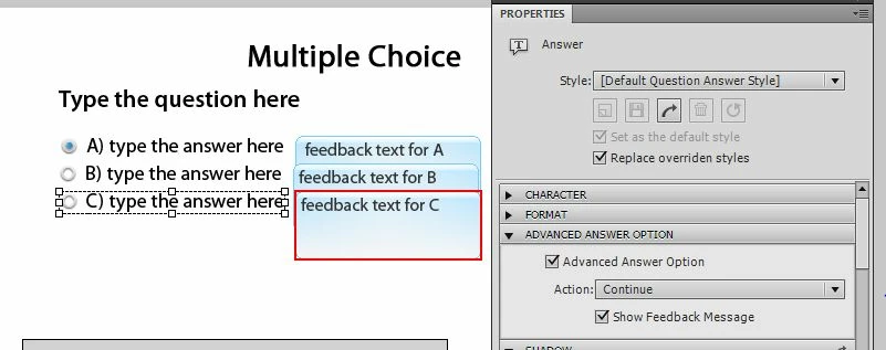

Hello Margot,
There is an Advanced Answer functionality. Select one of the answers (A,B...) and look in the Properties panel for the Advanced Answer option

Ok, so I have found the Advanced Answer Tab and the show Feedback Message and have customised this as I need. Thankyou.
When I test the quiz, I can make the first incorrect selection, getting the appropriate feedback, but when I go to change the response it jumps to the next slide.
I obviously need to change something in the Quiz Properties / Actions or another instruction. Also I read something about having to have a clear button or action to click anywhere to continue, so that the user is able to make second, or subsequent attempt if the first answer is incorrect.

Margot,
The Multi-Choice (NOT multi-answer) question type DOES allow you to choose an Advanced Answer options that mean you can show a different failure caption for each option.  Just select each answer listed, then go to Properties tab and checking the Advanced Answer option and Show Feedback Message. Then you can edit the text in the feedback caption as needed. You also have the option to trigger an Advanced Action if this answer is chosen (which would allow you to jump to another slide, etc)
Although you can convfigure a quiz question to have up to unlimited number of attempts, you are limited to only 3 failure levels. Which means that after the final failure level no more feedback captions will appear until your final attempt is reached, (e.g. 10 if you allow 10 attempts).  However, if you set to Unlimited attempts, this means you'll never see the final caption.
If you need more control than this, you might be better off creating this question from scratch using Captivate interactive objects (clickboxes, buttons, widgets) and Advanced Actions, rather than trying to use a Multiple Choice question quiz question type.  That way you can potentially allow the user to do the interaction and go to each option as often as they want.
