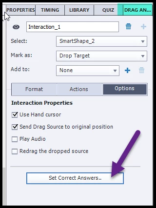

    Thank you, Stagprime! I did set the correct answers. And did use the Drag and Drop feature inside Captivate to do this.
    Lilibiri, I will try your suggestions and will let you know.

    So, it's the little things... I figured it out with both of your help!
    Thank you so much! I appreciate you taking the time to help a newbie/kindergarten teacher 🙂

    Stagprime2687219
    Jun 29, 2020 6:20 PM UTC
    Have you tried setting the correct answer through the drag and drop tab under  "Options"?
