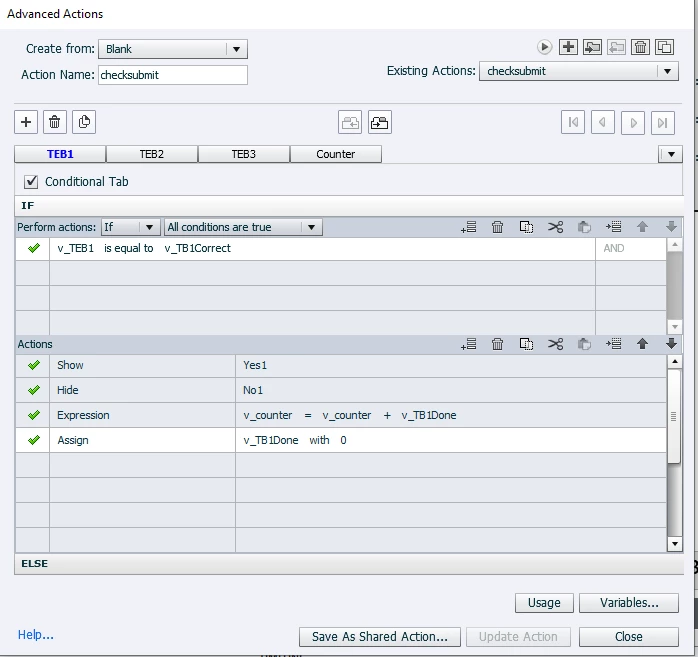

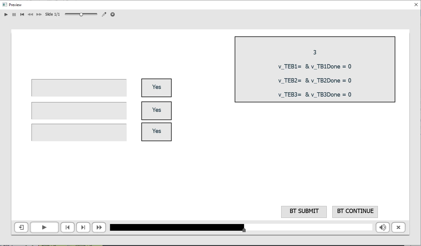

I have been trying to follow create an activity with multiple text entry boxes with one submit button. I have been studying this blog post Multiple TEB's - one Submit
and mine project looks exactly like the blog but it's producing different results. The text entry boxes need no validation and the person can put whatever they like into the TEB, they just can't leave it blank. I'm working on Captivate 9.

    You cannot use the workflow in that post, since it was meant for validated TEB''s.
    You will need to check if the entry is not blank. For that reason check this blog post:
    Where is Null in CP2017? - Captivate blog
    It was written for CP10, which means slight changes in the Advanced Actions dialog box.

    The problem with HTML5 output, contrary to SWF output is that it is not so easy to rewind the playhead before the pausing point of the TEB to allow another entry in the TEB.
    Since you do not need validation, I would consider using Scolling Text Interaction to replace the TEB's which are interactive. Scrolling Text ineractions are static, have an associated variable, you can allow to have the learner type in textt and you wouldn't have to rewind the playhead.
    I will create an example, and explain in a short post. Please have some patience.
