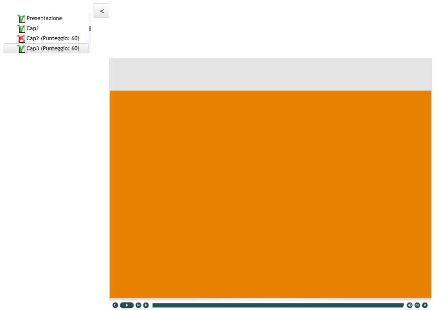

Hi Rod, this is the screen of the published scorm and the report.
"Punteggio" means "score".
Thank you
  • Score: 60,00 / 100,00
  • Report:
    • Nameprj
      • Presentazione
        • cmi.core.exit => suspend
        • cmi.core.lesson_location => BackToIndex_Result
        • cmi.core.lesson_status => completed
        • cmi.core.total_time => 00:00:12.75
        • cmi.suspend_data => F1A%24nP1A%24nP1A%24nP1A%24nP1A%24nP1A%24nPKPCompileUserMailBAQText_Entry_Box_8BAQText_Entry_Box_9BARText_Entry_Box_10BARText_Entry_Box_12BARText_Entry_Box_16BAONumeroCapitoloBAMCap1QuizUserBAMCap2QuizUserBAMCap3QuizUserBA%24_%23-%23_%24GAA_piuGNormal

RodWard
October 4, 2016
Sorry.  You misunderstood.  I want to see a screenshot of the Quiz > Reporting dialog INSIDE Captivate.  Not the contents of your SCORM log file.
