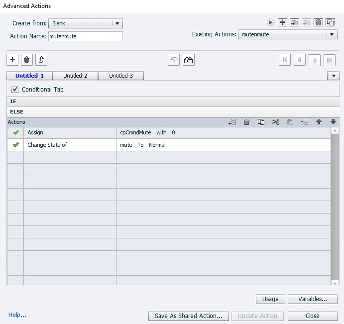

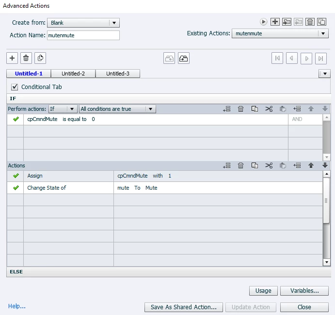

I followed the instuctions on a Mute button tutorial which seems to be working... state changes etc and sound switches on and off when button is selected.
However, i want the sound to play by default with the option to turn it off if the user does not want the commentary. Currently, it starts in mute and i have to press the button to switch the sound on. (button setup attached as per video)

You need to be careful with the 'default' situation of the system variable cpCmndMute. Its default value is 0. To make sure that is also the case when your project starts, please use the On Enter action of the first (or preferable second slide, if the first has no audio which is much better) for this command (simple/single action):
   Assign cpCmndMute with 0
Sorry, just looked at your screenshots: you switched the states. You show the 'Mute' state when the variable is set to 1 which means that the audio is muted, and the state should be Normal.
BTW: reading an advanced action is much easier when you use the Preview box. You open it using the first button in the top right control panel. That will allow you to see the THEN and ELSE part at the same time.
