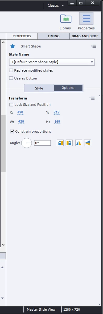

Lilibiri, can you tell me how to do that? I found instructions at the following link, but I can't find the "Master Slide Objects on Top" setting in the properties panel, so I don't have any idea what to actually do.
https://helpx.adobe.com/captivate/using/slide-properties.html
Here's what my properties panel looks like when I select a shape on the master:

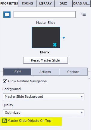

You are showing the Properties panel for a shape, you need to choose the Properties panel of a slide. In the Style tab you choose the master slide, and you'll find the option On Top:
I inserted the X (shape button) on the main master slides. All daughter master slides, if the option to include Main master objects is chosen, will show this shape button. It can be hidden behind other objects on the slide, but if you check 'Master Slide Objects On Top' it will have priority in the stack and be on top of everything.
