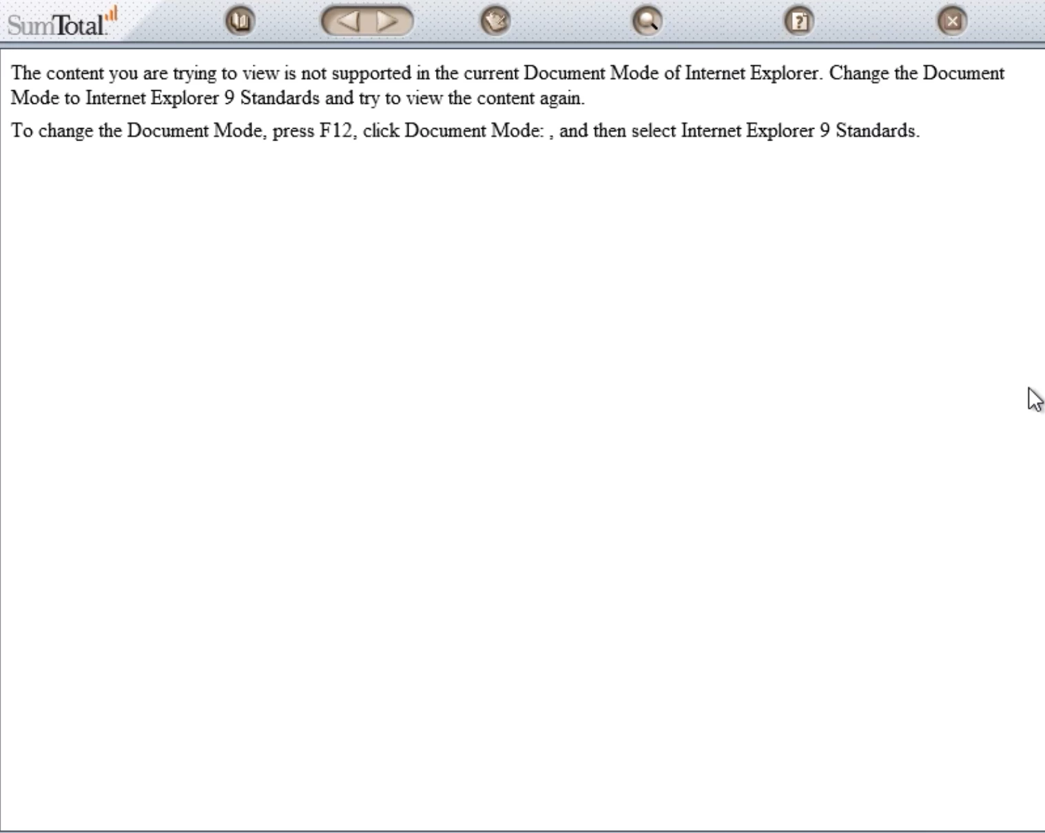

Thank you for the immediate reply. And I also immediately tried uploading in 2004.
The same display appears in both 1.2 and 2004 this time. Do you know the countermeasures for this display?
OK.  Well this is a somewhat different issue.
From what you are showing here. your LMS does support SCORM 2004 but the message you are getting relates to it not liking the Document Mode. Captivate is publishing HTML5 content and your LMS is expecting HTML4 or similar so that IE9 users could view it.
But is your organisation really still using Internet Explorer version 9?  If so, then nobody using that browser version is going to be able to view your Captivate content because IE9 is not HTML5 compatible.
If IE9 is NOT your default browser version (which I strongly suspect) then you need to go back to your LMS people and ask them what they need to do in order to make your LMS HTML5 compatible.  This would certainly require some kind of adjustment in the server settings or even perhaps the templates that SumTotal is using.  There is absolutely NO reason why any organisation nowadays should be mandating support for IE9.
