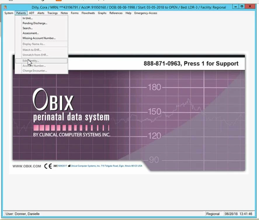

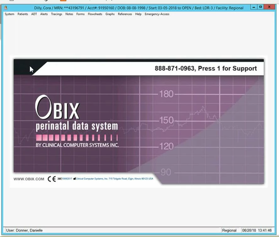

Hello, I have a menu in our software that I recreated in captivate. I used rollover states to create the rollover feature of our menu and it works flawlessly going down. Scrolling back up though it phases out from the last button to nothing before it loads the picture in the rollover state of the button above. This is done in HTML5. Anyone have any ideas or suggestion why this is happening?

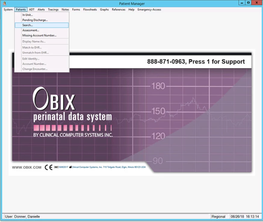

July 9, 2018
They do not overlap, but the edges are right on top of each other.
The first four are like this: x:37 y:31 w:147 H:15 ; x:37 y:46 w:147 H:15 ;  x:37 y:61 w:147 H:13 ;  x:37 y:74 w:147 H:13 . I am pretty particular to detail so each one hits exactly to the next like the four above.
I actually did use transparent buttons, not shape objects.

July 9, 2018
OK for the button type, but I fear that they are too close to each other. Combined with so many interactive objects on one slide (although they don' 'do anything) this could explain the problem.
The only way to find out is to decrease the height of the buttons.

I am on version 9. And yes the rollover state is in the buttons I created. I recreated (pictures to come) a menu from our software by putting invisible buttons over the menu. When I come from the top and go down button to button, the rollovers are flawless. But when I go back up from bottom to top, the fade in showing the background between shots.
coming back up...
There is an invisible button with a rollover on each menu choice.
