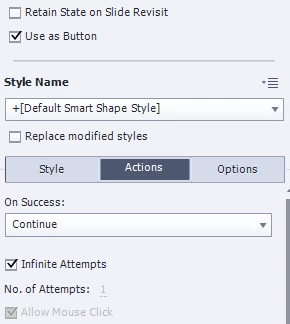

    You can create a smartShape and place the text inside the shape.
    Set the properties for the shape to 0 for the stroke and 0% for the opacity.
    Then you can click the box that says to use it as a button.
    Hope that helps get you started.
    Let me know if you need any more on that idea.

    So basically you will need to create two boxes.
    Box 1: This is the text button that says 'Click HERE for a hint'
    Box 2: This is the pop-up.
    Box 2 will need to be hidden.
    Box 1 will have an onSuccess action that will show the hidden box. This is the "what will happen when I am clicked" information. This can be found in the Actions tab when the button is highlighted.
    My action says 'Continue' but you can change yours as appropriate.
    If you plan to have a ton of boxes with corresponding hints - I would recommend creating multiple states for the pop-up box.
    Does that help clear things up?
