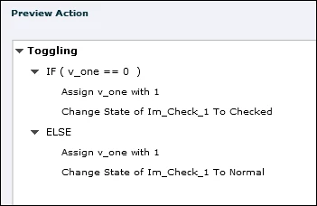

    Create 3 user variables: v_one, v_two, v_three with a default value of 0. They will track if the check box has been marked or not. Value=0 means not checked, Value=1 means checked.
    The images for the check boxes have two states:  Normal (no checkmark) and Checked, the image itself I will label Im_one, Im_two, Im_three
    Create the Text caption or shape with text, label it Message and make it invisible in output (eye icon on Properties panel).
    Each of the transparent shape buttons over the images has to trigger a conditional action; I would create a shared instead of an advanced action. It will look like this (example for first action):

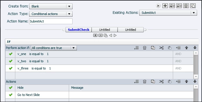

    As for the Submit button, this conditional advanced action will do:
    The ELSE part has only one command: "Show Message"
    Be sure to put the pausing point for the 4 shape buttons at the same place.
