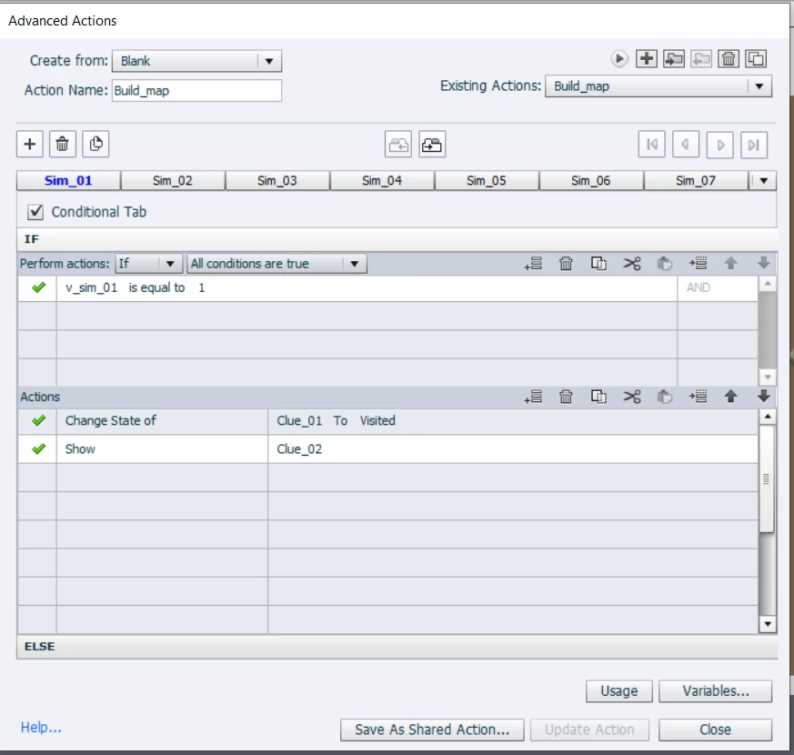

    Thanks so much for your reply. I was going about this backwards, trying to have a variable on my home page that was incremented each time the learner revisited it, and was failing miserably. 😉  I tried your solution but for some reason it is not working, and I can't figure out why. Here is a screenshot of the Advanced Action on my homepage:
    In this screenshot, you can see that when the variable on my first simulation is set to 1, two things happen: I change the state of my first image (clue 1) to visited, and then show my second image (clue 2). However, when I publish the project and test it, clue 1 does indeed change to the visited state, but clue 2 does not show.

    I've reviewed your instructions and my scripts several times, and can't see the error. Any thoughts?

    The most likely reason for your problem is due to the order of your decision blocks.  A later decision block is causing Clue 2 to be hidden again.
    Try reversing the order of your decision blocks.  Put the one currently in first place at the back of the order and see whether that then means your second button is visible when you test it.
