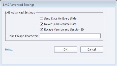

Has anyone had a problem and found a solution to remove bookmarking functionality using Captivate 9 after using the below setting?

    Thanks, I just realized that Never Send Resume Data functionality works on our LMS if I publish using SCORM 2004.

    That setting would remove bookmark functionality if you are working with a LMS.
    If you are not working with a LMS, you have to check in the TOC settings : Self-Paced Learning should NOT be checked.
    SM6601Author
    December 28, 2016
    It's not removing bookmarking on our LMS when Never Send Resume Data is checked.
    Could be an issue with our LMS.

    To check that, you could upload for testing on SCORM Cloud.
