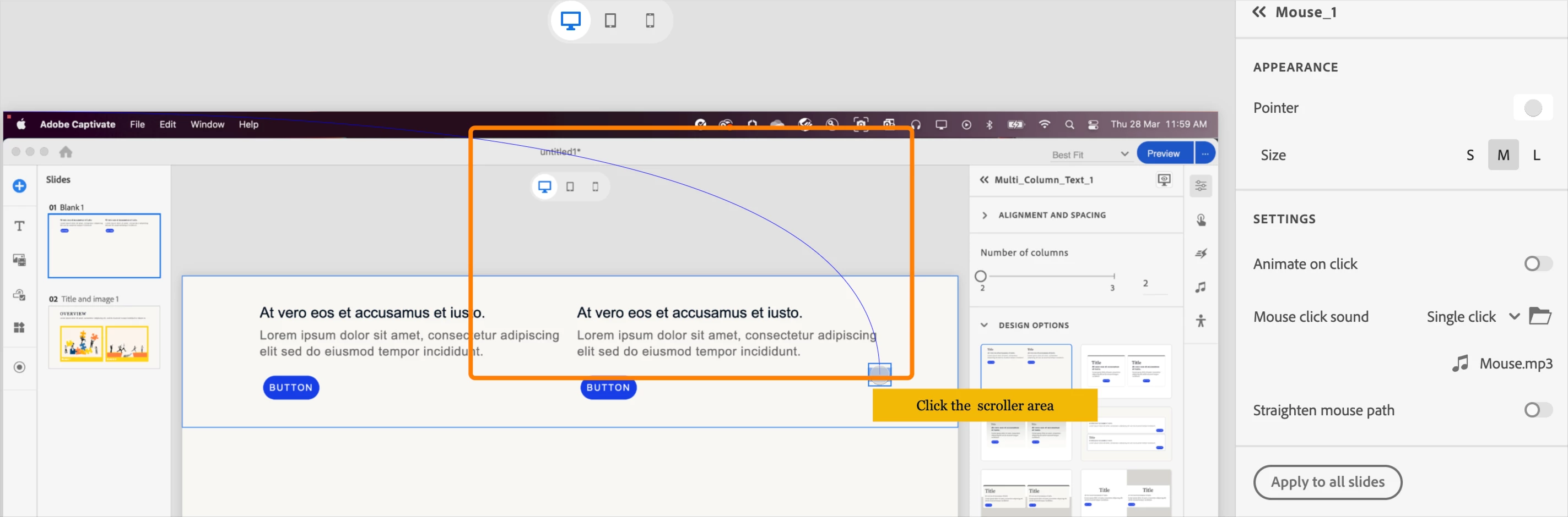

New Captivate Mouse Object Length
Hi all - in Captivate Classic I was able to shorten my mouse length to 1 second and apply to all slides.  I cannot work out how to do this in the All New Captivate which is a nuisance.  Does anyone know if this is possible?  I asked ChatGBT but it could only give me answers from old Captivate which was no help.   Thank you

Just wondering: full control over the mouse object was possible in a Video Demo, not so much in a software simulation. Are you sure that you are not referring to the Video Demo, which is not yet available with the New Captivate?

Hi I appreciate the comment - no it is all Software Simulations that I do in Classic - I don't use templates, everything I do is using Software Simulations and I edit them heavily so they are short snappy videos.   In Classic after I straighten the path I then shorten the mouse length to 1 second using the TIMING tab but there is no option to do that in v12 - I can grab it in the timeline and shorten to 2 seconds but I then have to do that in every slide which is incredibly repetitive.  In Classic I can edit the mouse how i want on slide 1 and then apply to all slides very easily.  It's such a simple task that I find it incredible that I cannot do that in the new software.  Thanks

Hi @Laura Cee  I am assuming you're working on simulation projects in the new Adobe Captivate. If yes, select the mouse path.
You can toggle the Straighten the mouse path option in the Visual Properties panel. This will shorten the path length. You can then apply the change to all slides by selecting the Apply to all slides button.

Hi I appreciate the comment - yes I know I can straighten the path, however in Classic after I straighten the path I then shorten the mouse length to 1 second using the TIMING tab but there is no option to do that in v12 - I can grab it in the timeline and shorten to 2 seconds but I then have to do that in every slide which is incredibly repetitive.  In Classic I can edit the mouse how i want on slide 1 and then apply to all slides very easily.  It's such a simple task that I find it incredible that I cannot do that in the new software.   Thanks
