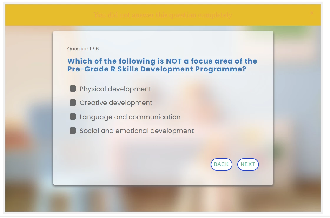

    Hi all. I am running into kind of a similar issue:
    In the published SCORM file viewed on the LMS, (also on project preview) the course skips over 4 video slides, and goes from slide 6 to slide 11, which is an intro slide to the quiz; then it skips over the first question (multiple choice), shows the second question (true/false), skips the 3rd question (multiple choice), and shows the rest of the questions (all true/false).
    After the quiz results slide, it now shows the videos it skipped earlier?..
    And then, it shows the two multiple choice questions but says "you did not answer this question completely":
    Did I perhaps press a keyboard shortcut which hides a slide, or is there another hierarchy for the slides which I might have jumbled up, which causes it to ignore the order of my slides?
    Another problem is that the "review quiz" button also does nothing...
    Your assistance is much appreciated!
    May 28, 2024 10:52 AM UTC
    I had a similar issue: try checking the TOC (Window > Table of Contents). I had the TOC set to not be visible to users, but the slide order was incorrect when I viewed it. You need to set the TOC to visible and then reorder the slides into the correct sequence. (You can then hide the TOC again if that's your desired behaviour.)
    FrancoisK
    Jun 4, 2024 11:47 AM UTC
    Thank you so much for this Laren, and also Amit from support - this was exactly the issue!
