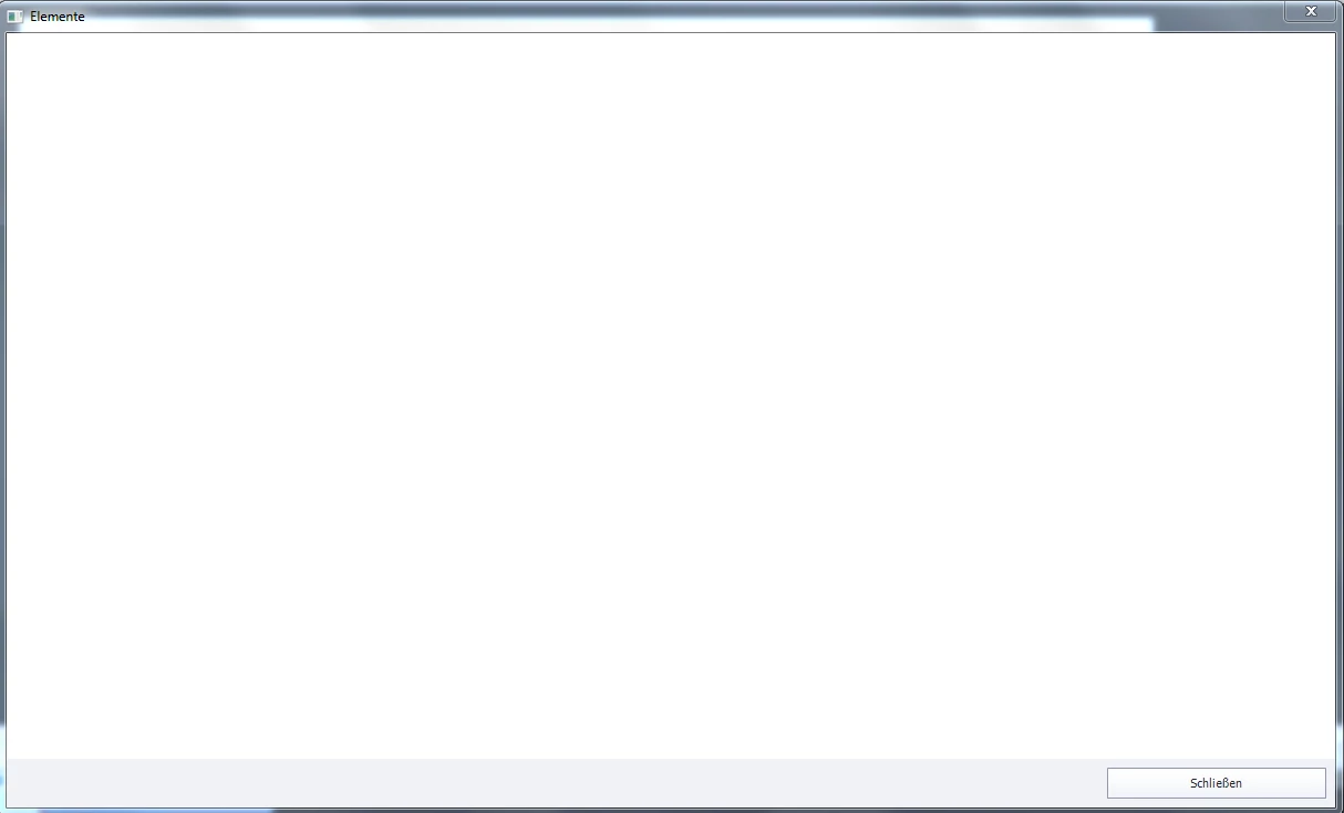

Hi all,
we have installed Capitvate 9 64-bit on Windows 7.
We have the issue, that when you click on the "Assets"-Button, there is only a blank screen shown.
It might be a problem with our proxy or firewall settings. I found a similar problem in the discussions, but there was no solution so far.
The question is, if some special ports in the firewall have to be opened to allow the communication with elearning brothers.
Thanks a lot in advance.

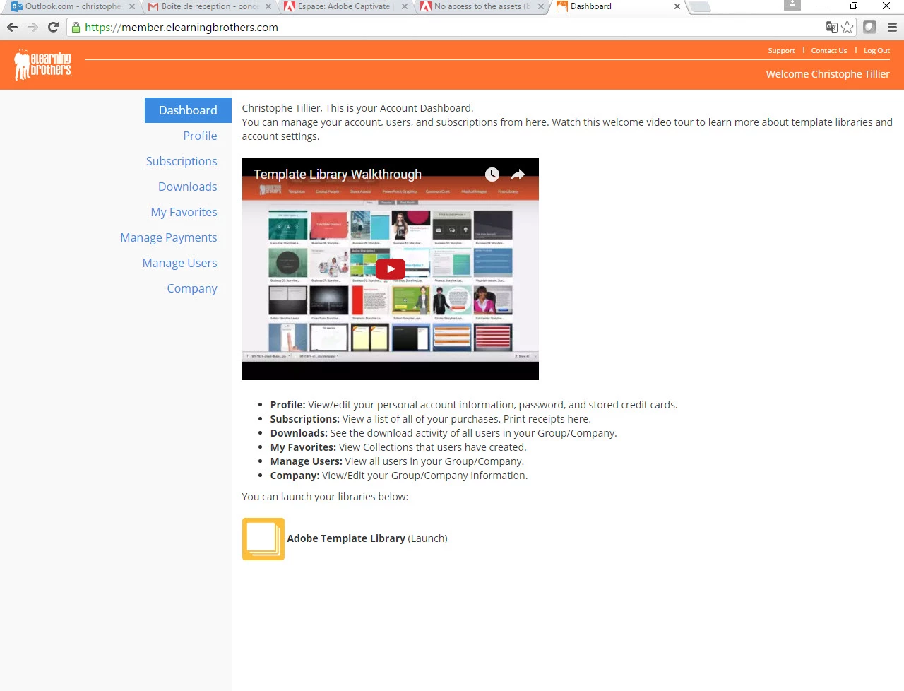

    christophet11731756
    July 18, 2016
    That's strange, do you try to go directly on the elearning borther website: https://member.elearningbrothers.com/
    Do you try with a low proxy protection?
    Could you take a snapshot of your screen?
    gerritk16923417
    July 18, 2016
    The direct link to the website works fine.
    For me it`s not possible to change the proxy-settings. These settings are deployed by our network-team.
    Also the geofication is not working in Captivate.
    I did a short test with the colleagues from network-team:
    Our proxy-server needs an authentification. We suggest, that captivate opens the web-connection and is getting to the point, where the authentification must be done. But there is no pop-up or anything else, where the authentification could be done. So at this point, there is no further action and the blank screen remains. For testing the network-team disabled the authentification-procedure and after this, the screen appeared in Captivate directly. After changing back to the authentification-procedure, the screen is again blank.
    In Captivate I also found no setting, where I can set up the proxy-authentification credentials.
    The screen that appears is attatched.
