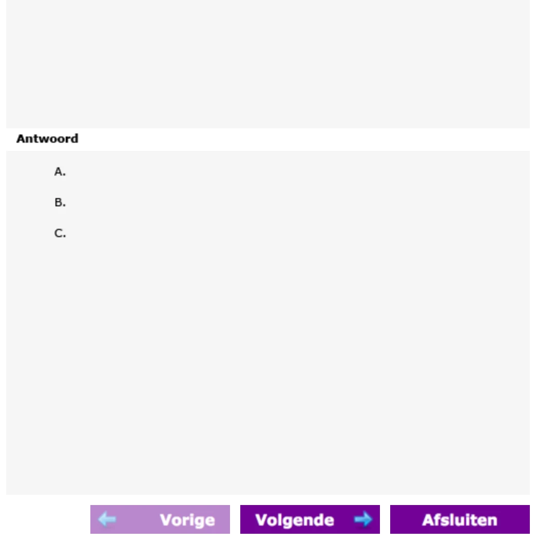

    Just to be clear about what is missing from your Review slides, could you also please show a screenshot of one of these slides?
    Mar 22, 2019 3:21 PM UTC
    This is what i see

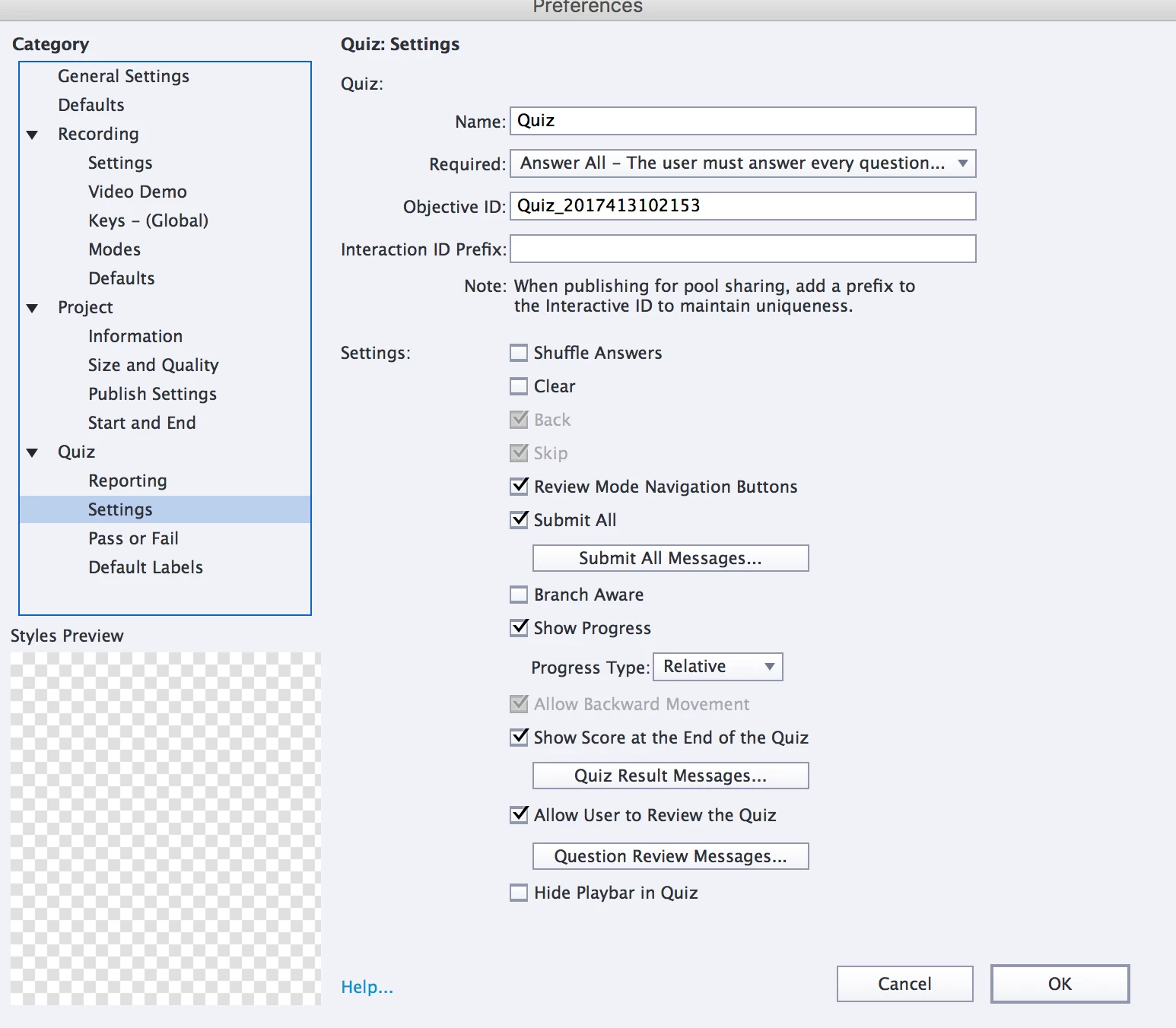

    Which version are you  using please? Did you activate Review in the Quiz, Preferences? Which theme do you use, is this a theme created in this version or an upgraded theme?
    Mar 22, 2019 10:32 AM UTC
    These are my setting:

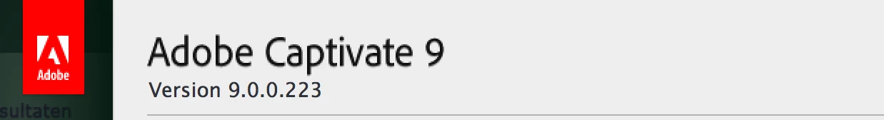

    Mar 22, 2019 11:02 AM UTC
    You are still on the first, very buggy release of 9, missed 3 patches. Please upgrade ASAP to 9.0.2.
