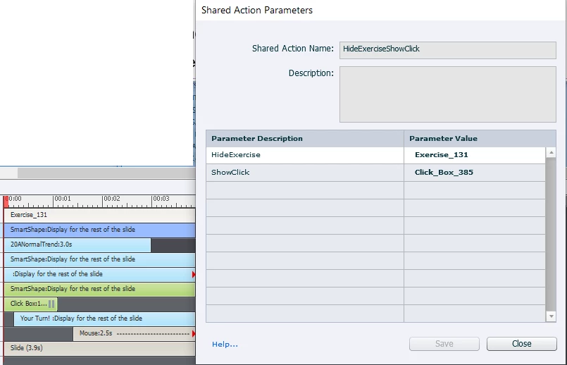

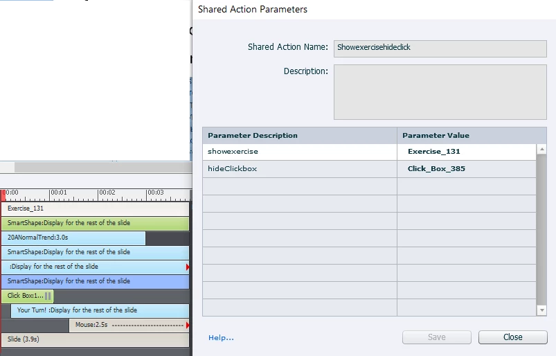

    Thank you for your responses. Ill try to tackle that. Here is what I am currently doing, if it makes my question make more sense.

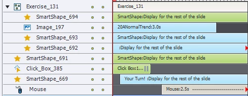

    1. Here is a typical timeline of a slide:
    2. The Exercise Group object is set to Not Visible in output
    3. The click box is the challenge area for the stident to proceed to the next slide
    4. Smart Shape 691 is used as a button to show the exercise. A hide was used on the click box to prevent attempts on the click box while the exercise is opened. It works.
    5. Smart Shape 694 in the exercise group object uses an action to hide the exercise group and show the click box again.
    6. I copy the exercise group, the smart shape to view the exercise and the click box to the next slide, which already has its own click box.
    7. I then go to each the view button and close buttons and change the show and hide click box parameter values to the click box on the new slide.
    8. Delete the copied click box
     I know this seems complex. Probably an easier way with a more complex logic applied. I will try Lily's advice.

    Click box cannot be timed for the rest of the project, it is an 'old' interactive object (probably to be deprecated soon). That is a first hurdle. Replace it by a shape button which you can make invisible by setting Alpha for the Fill and the stroke to 0.
    Time the group for the rest of the project, time the two shape buttons for the rest of the project. Now they all have only one ID, and there is no need for shared actions at all.
